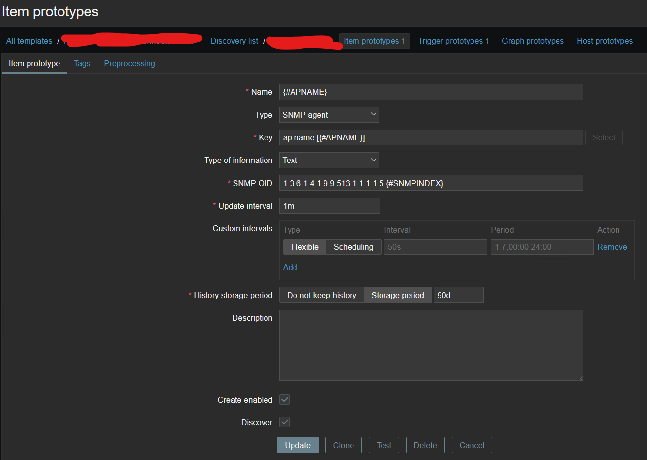

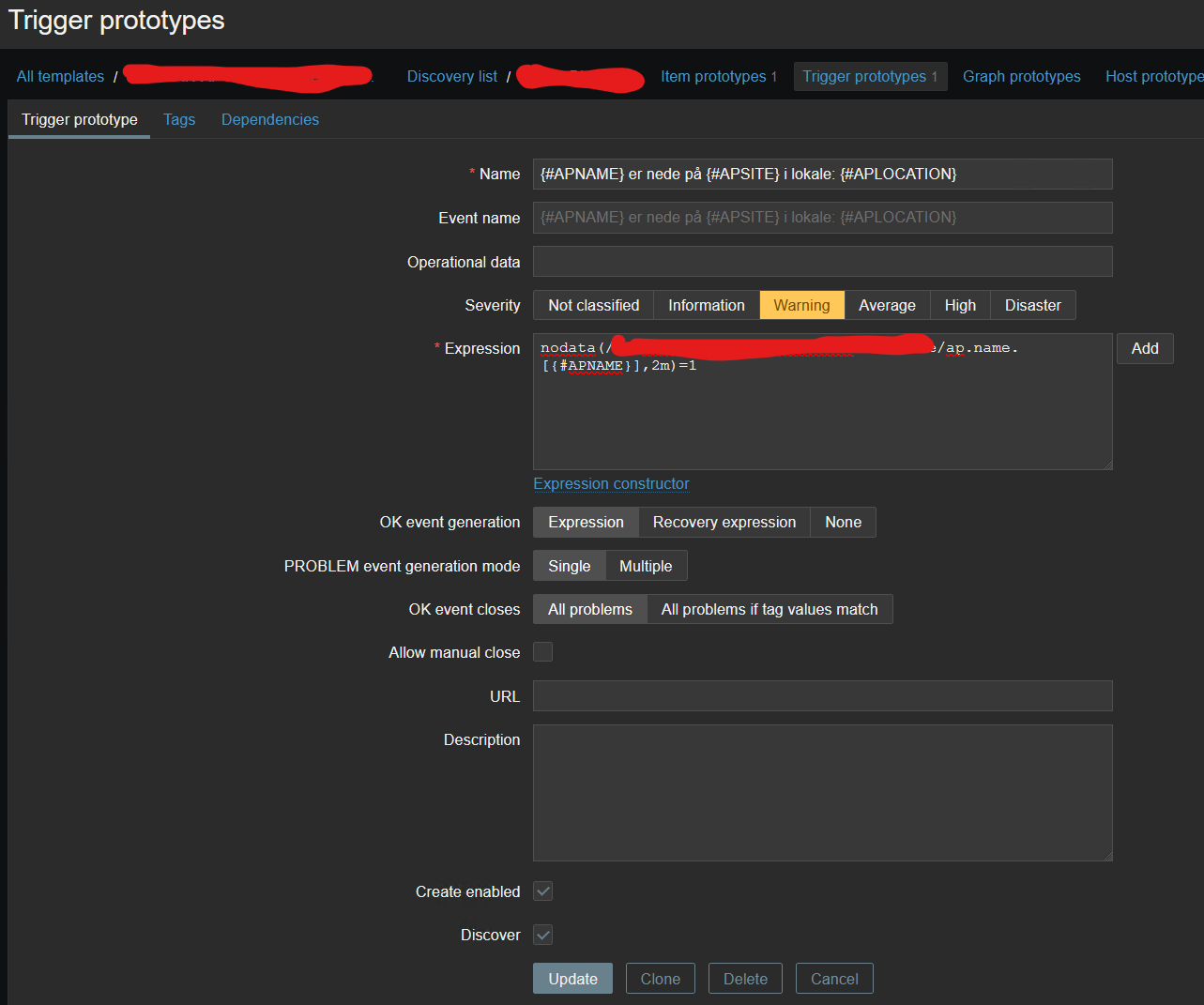

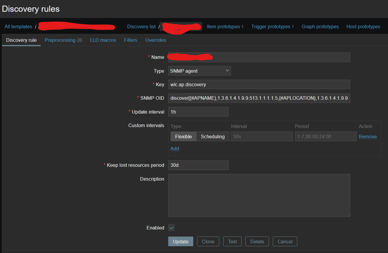

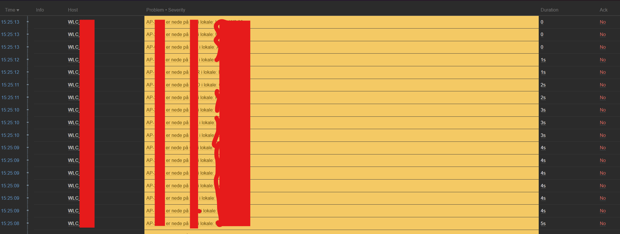

    I have created a template to discover the access points on my WLC with SNMP, i discover the AP-NAME, AP-LOCATION and AP-SITETAG. What i want it to, is tell me as soon as one of the AP's are down on the WLC and then tell me what AP is down, on what SITE and in which ROOM.
    I got that covered and got the output i wanted.
    But as there is a lot of data (abit over 900 Access Points on one of my WLC's) the data can not keep up, and i then get loads of the triggers since it loses data.
    So, what can i do different so i can get this to work as i want to? And is it even possible with over 900 AP's?
    I have attached screenshots of the Discovery rule, Item prototype, Trigger prototype and the output of when hell breaks loose.

      I have tried splitting my Discovery rule up into 3 Discovery rules and then filter each rule so they would get less data. Still the same problem.

          I've had the discovery rule running on a WLC with only 53 AP's (a virtual appliance we use for flex connected AP's) and here i don't get any AP triggers. But as soon as i enable the discovery rule on my physical WLC. The Items are beign discovered, inputtet as items under the WLC host in Zabbix and then after the first round of update interval. half of them appears to be offline and i get spammed with my triggers.

              If you have 900 APs, is it necessary to check their names and locations every 1 minute? (That's 900x3 = 2700 requests every minute = 45 SNMP requests per second just for those APs)

                No it is not. What i want my rule to do, is discover the AP's on the WLC (doesn't even have to be every hour as we rarely do configuration on them). But trigger when there is no data for the AP on the WLC.
                If only i could find an OID to get AP in the "NOT JOINED" state from the WLC, it would be much better, but i can't seem to find it.
                I have tried making my discovery rule update interval to 1 Hour, Item Prototype to 2m and Trigger Prototype 5m. Which in my head, tells me it checks if the items is there every hour, updates the items every 2 minutes, and if there has been no response from it after 5 minutes, it should create a trigger.
                  Correct.
                  You can even make the NAME update to be that 2m (to be used with the nodata() trigger), and LOCATION and SITETAG updates like 1 hour.
