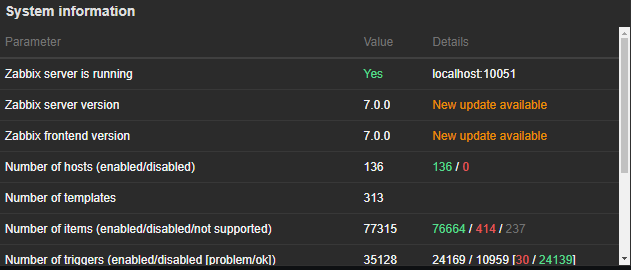

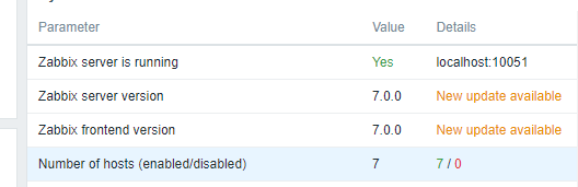

    Update steps 7.0 to 7.0.1
    I have this on my dashboard. But there is no link to process the update.
    How do I update?
    Thank you

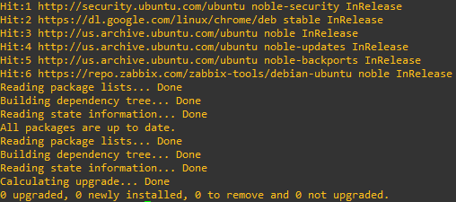

        I've tried this, but there is nothing to update...
Name:	Screenshot 2024-07-23 123833.png

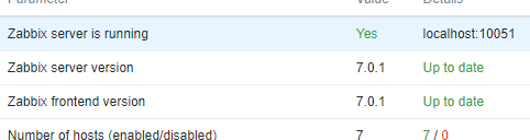

          Thank you!!! So what I did, was just run this... "sudo systemctl stop zabbix-server"
          then run the sudo apt update && sudo apt upgrade - I saw it install the zabbix items
          And when when I rebooted and opened the website, it showed the new version!!
          Thank you - I have had such bad luck in the past with updates.. But I hope, just stopping the server helped...
              You don't have the Zabbix server/proxy/agent repo installed. Follow the install instructions in the download page.

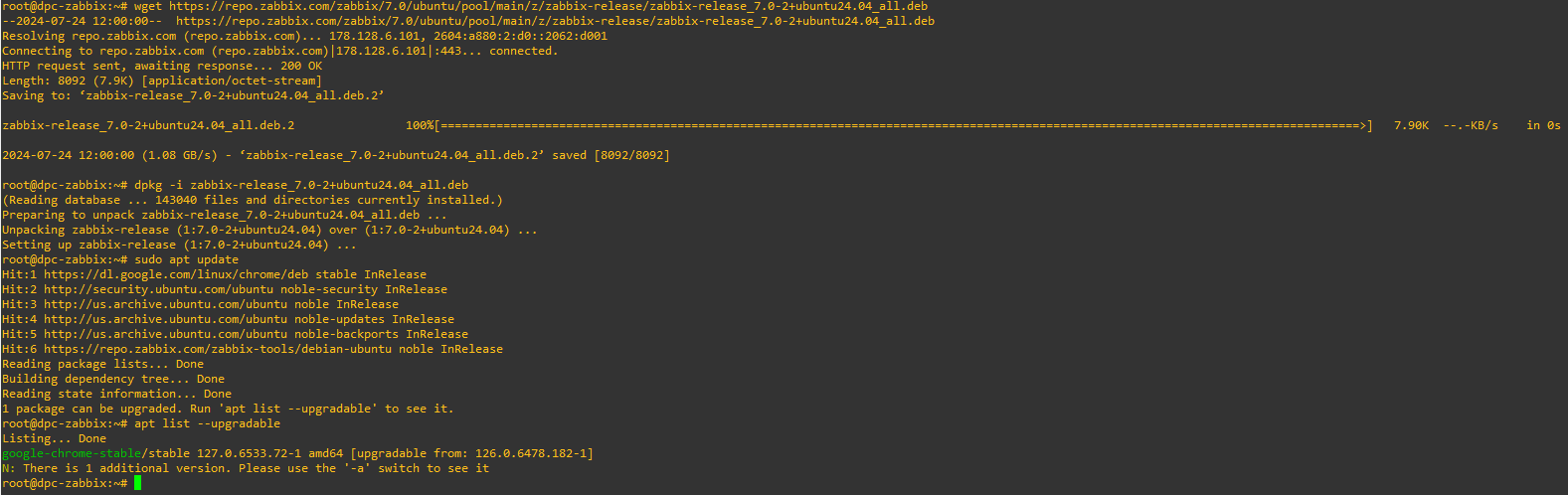

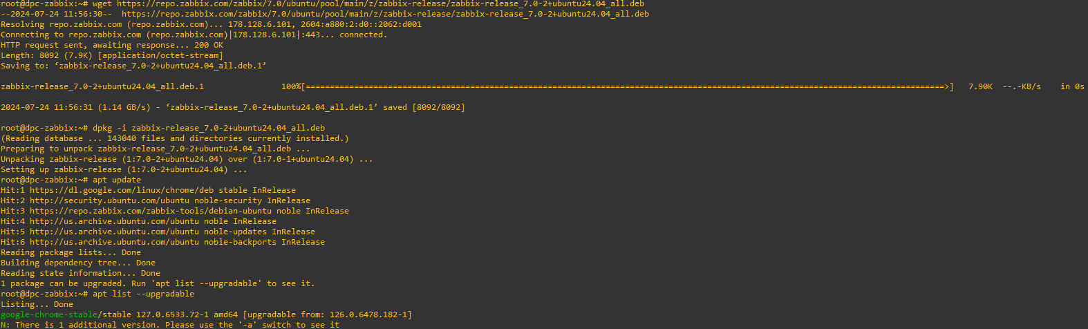

                        I did this when I first set up Zabbix. I did it again for good measure. The update still does not show. What am I doing wrong?
Name:	Screenshot 2024-07-24 080042.png
Name:	Screenshot 2024-07-24 080120.png

                          Note that your downloaded .deb was named as ".deb.2" and you installed the ".deb" one, if it makes any difference.
                          I'd suggest the following:
                          sudo apt purge zabbix-release
                          sudo rm -v /etc/apt/sources.list.d/zabbix*
                          (if there happens to be something still)
                          sudo dpkg -i ....deb
                          sudo apt update
                          Markku
                          • cjbruck
                            • Jun 2024
                            • 11
                            sudo apt update
                            Markku
                            That fixed it, thank you!
