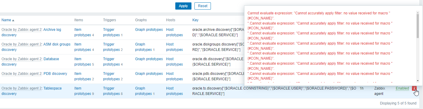

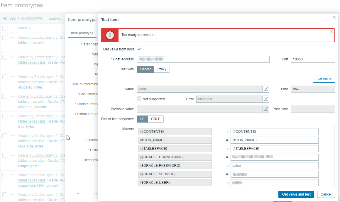

    Hello everyone. I have Zabbix 7.0 installed and am monitoring an Oracle database. The template is working partially, since it is collecting all the data except those related to the discovery rule called "Tablespace discovery." It gives me the following error: "Cannot evaluate expression: "Cannot accurately apply filter: no value received for macro "{#CON_NAME}"." When trying to evaluate a single monitoring Item it gives me the following warning: "Too many parameters."
