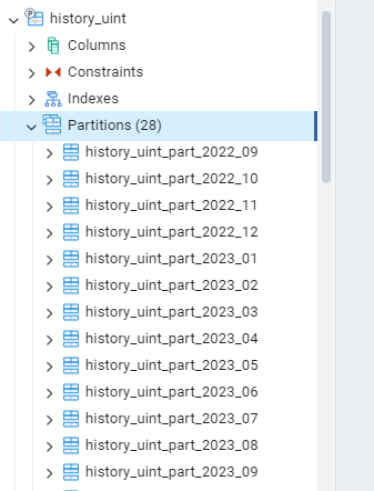

      manually means using sql commands, may be the picture will help to understand

        This sounds like similar setup that is needed with MySQL/MariaDB (but someone PostgreSQLista please confirm): no native support in Zabbix to maintain the partitions. (Ref: https://blog.zabbix.com/partitioning...cedures/13531/)
        If that is the case, then Zabbix does not care about the partitioning, it is just an internal implementation detail of the database engine, some other party takes care of the partition maintenance. Thus the Zabbix software upgrade should work normally.
        Of course it is advised the arrange a similarly configured copy of the database and test it offline, before actually upgrading it in-place (and have backups up-to-date nevertheless).
