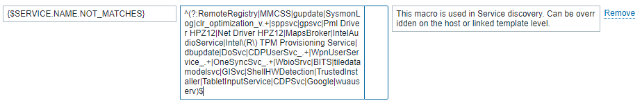

    Despite the fact that the factory templates have this useful feature, it is inexplicably not mentioned here:

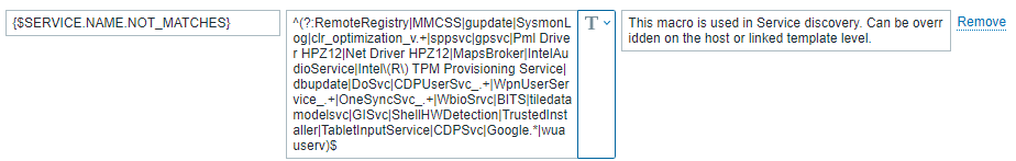

      So I can just make it as below with "|google|" added and it will not report on any services that have google in the name?
        Click image for larger version  Name:	image.png Views:	0 Size:	23.2 KB ID:	488559
        You should use some regex operators aswell. For example, if you desire to disable the "GoogleUpdaterService128.0.6597.0" service, you would need to write the whole service name in the "$SERVICE.NAME.NOT.MATCHES" macro, so, instead of writing the whole name, you can simply use a regular expression, like: Google.*
        Using a regular expression is also useful when the service name may change from time to time (just like this google service).

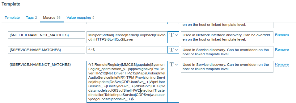

            I have the template set as below but, i'm still getting the "Problem name: "GoogleUpdaterService128.0.6597.0" (GoogleUpdater Service 128.0.6597.0 (GoogleUpdaterService128.0.6597.0)) is not running (startup type automatic)" showing up in notifications..
                The filter is on discovery, so only applies at the point of discovery. If you re-run the discovery, then the Google services will have a [!] next to them if your filtering amendment has worked. Then it will say how long it will be until they are deleted. IF it says they're going to be deleted, you can just delete them manually.
