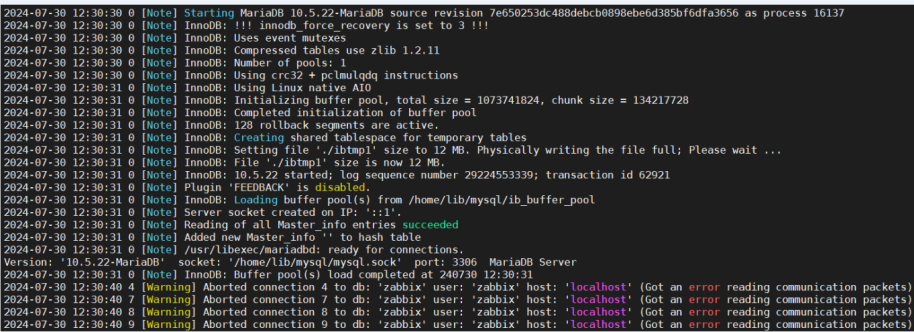

    Hi, I installed Zabbix-server 6.0 on CentOS Stream 9 with MariaDB 10.5 and I get the following error when starting zabbix-server:
    I also had a problem with zabbix when I changed the MariaDB path from /var/lib/mysql to /home/lib/mysql. The mariadb service still runs fine, however when I restart zabbix-server it fails. If I go back to the original MariaDB path it works fine.
    Does anyone have any solution?

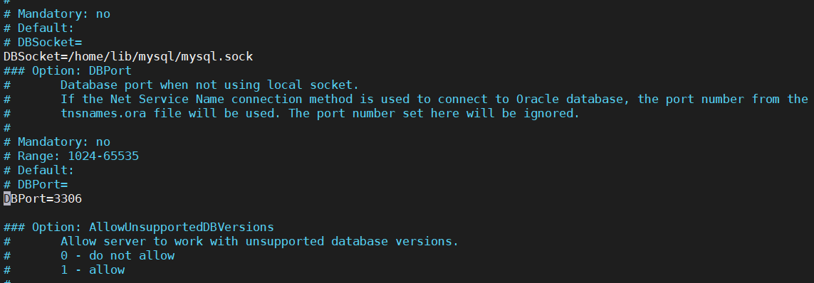

    If you want to use the local socket, try removing DBPort, it doesn't make sense.
    Markku

      Hi Markku
      I did not use DBport and tried again, however it still did not fix it.

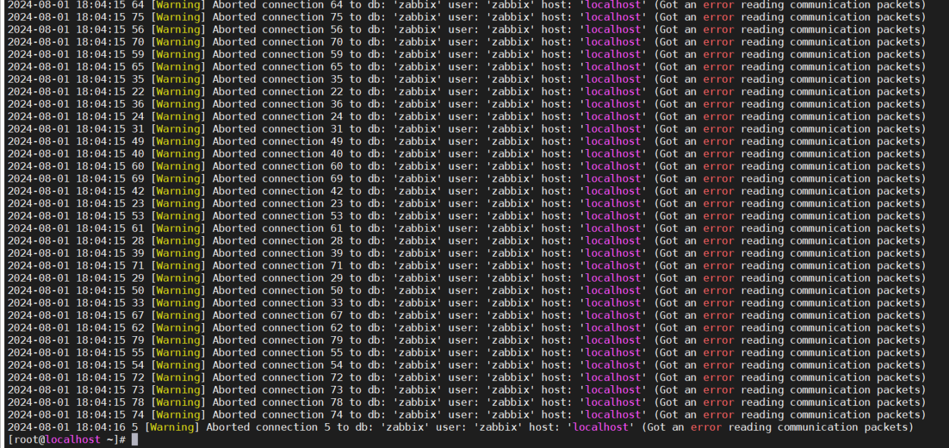

      This is my mariadb status.
      Click image for larger version  Name:	image.png Views:	0 Size:	250.9 KB ID:	488838

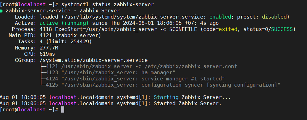

      This is my Zabbix-Server status.
      Click image for larger version  Name:	image.png Views:	0 Size:	53.1 KB ID:	488841​​

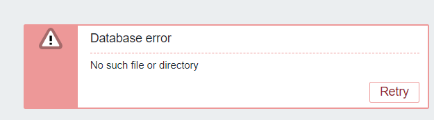

        About the error in the UI, how is your UI configured? That is different from zabbix_server.conf.
        Markku

            No, I'm talking about the Zabbix UI configuration, how does it try to reach the database.
            /etc/zabbix/web/zabbix.conf.php (at least in Debian)
            Markku
