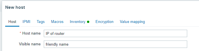

    I just recently tried using Zabbix, and it's good and simple I tried to find a way to add my router, but some of my routers do not support SNMP, how I can add this router as host, I use icmp ping as template but for interface I am still confused because there is no option to add based on ping just agent, snmp, jmx, ipmi
    I try to add as agent but the icons till grey after one day and also add snmp
    how I can solve this
    thank you.
    See image.
    Only not sure which field the ICMP template uses. If it uses {HOST.CONN} than this could fail because no interface is there.
    Than change this macro to {HOST} (I would suggest create your own template and copy the items from the original)
