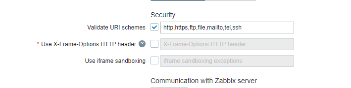

    i got a other intern website where i will like to show some of the dashbords from Zabbix like "https://URLXXXX/zabbix/index.php?name=XXXXXX&password=XXXXXXX!&enter=Sign &action=dashboard.view&kiosk=1&dashboardid=172"
    it is working super in the brower but i need to drop it in a iframe. to fit the pages
    as you can see i have turn off the X-Frame and the Sandboxing. so out from that it has to work right ?

  • Answer selected by ducksteb at 05-08-2024, 10:03.
    ducksteb
    • Aug 2024
    problem solved it where not the x frame options
    but cookie's SameSite property
    Click image for larger version  Name:	image.png Views:	0 Size:	13.2 KB ID:	489010
    for others there run in to the same problem as me.

        • ducksteb
          • Aug 2024
          one the server where you like to show it.
          you have to add it in the apache config of the vhost.
