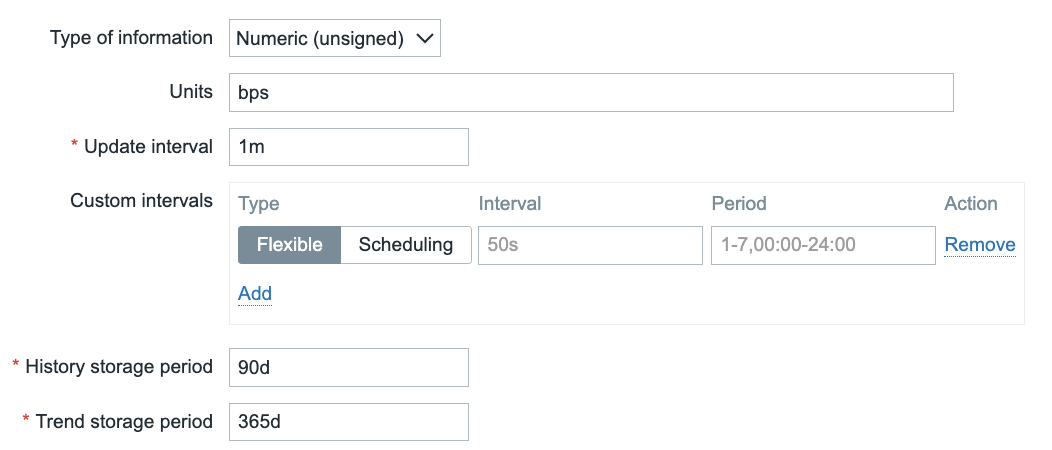

    I've configured an item as below and would like to know if history data or trend data is used to calculate a percentile line.

    (1) If a x axis shows 90 days, is a percentile line calculated from history data, which means every 1 minute data?
    (2) If a x axis shows 180 days, is a percentile line calculated from both history data and trend data, which means every 1 minute data for last 90 days and every 1 hour data for days before that?
    And which data (min, avg, max) is used for the trend data?
    Thanks advance for your help!

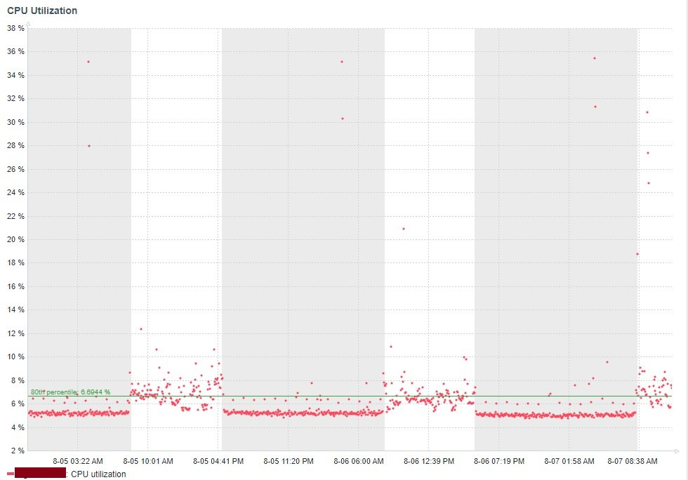

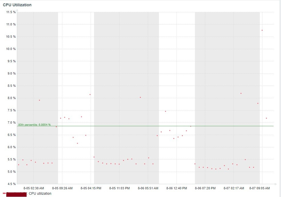

            I think the percentile calculation is done dynamically using the values ​currently displayed on the graph.
            Whether history or trend is used for graphs seems to depend on the amount of data to be displayed.
            I set the time width to the limit and confirmed how changing the time width by 1 second switches between using history data and using trend data.​
            [now-219825s to now]
            [now-219826s to now]
            Although the time axis is 1 second apart, the percentile differs between 6.6944% and 6.8654% depending on the displayed data.
            In my test environment, there was not much data accumulated, so I was unable to verify how it behaves at the last 90 days of the historical data retention period. sorry.
