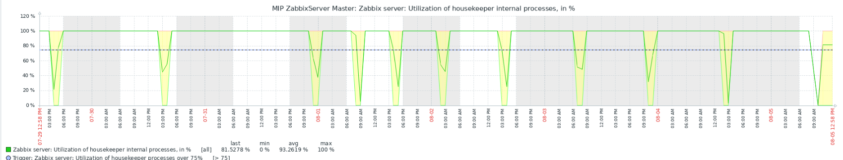

    We have quite the large Zabbix server and we are having a issue where housekeeper is not cleaning up quick enough and the housekeeper process can take up to 12 hours per run.
    Attached is the utilisation graph.
    Any tips to speed up this process?Click image for larger version

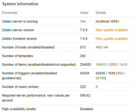

    We are running:
    Linux Red Hat 8.8
    12 CPU's and 64GB ram
    PostgreSQL 13.
    PostgreSSQL and Web are on the same server
    We have even tried increasing Pollers, which I see is a bad idea.

    Most of the Hosts are direct to the Zabbix Server, and 3 Zabbix Proxy servers are used for a few of hosts.​​
