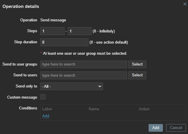

      I have thought about another way, I have added Global Script to Zabbix UI, and now I am trying to create Trigger Action which will listen to the trigger of the ICMP, then execute the command, but I can't change the 'Operation' drop down menu:

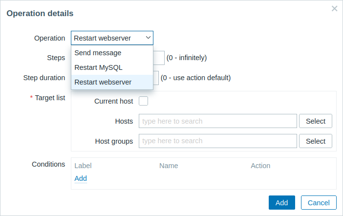

      this is on the WIKI:

    ***Found my issue, the script was configured on 'manual', after change it to Action Operation I could set it in the trigger.

    This is the WIKI:
    Click image for larger version  Name:	image.png Views:	2 Size:	42.6 KB ID:	489518
    This is mine:
    Click image for larger version  Name:	image.png Views:	2 Size:	26.0 KB ID:	489519
    I have change the global scripts on the Zabbix Server, but still I can't change it.
