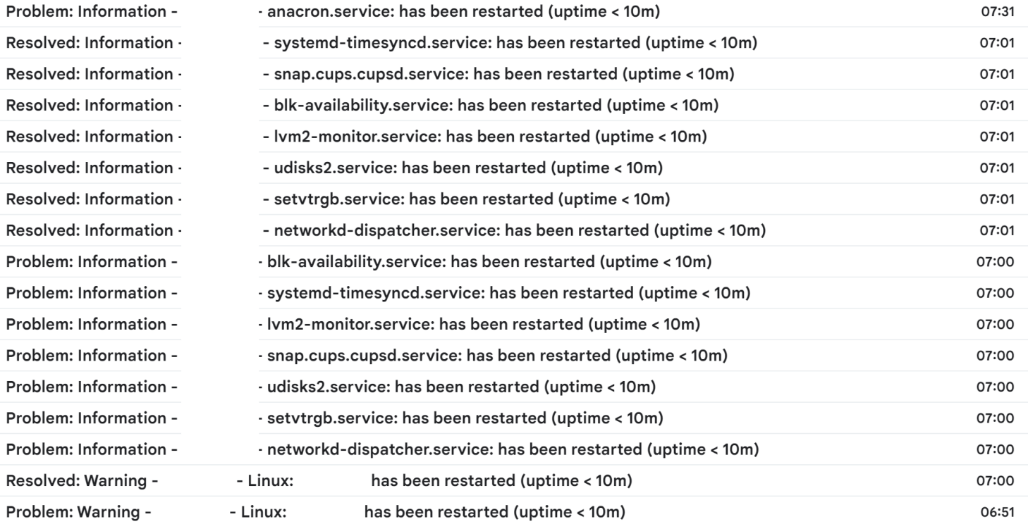

              Unfortunately it doesn't seem to quite work....The device was restarted normally during our maintenance window, and the alerts were muted as expected.
              It was then restarted again at 06:50 (or there abouts) and we received this (and only this) for this host...any other pointers?

                Looks like the system restart alert resolved before the 10 minute mark and that allowed the other alerts to come out. The first question I have is, how important is for you to know if a linux service restarted? As you can see they are informational in nature and most of these are of the generic nature. You should be discovering only the services you truly care about.
                But back to the triggers. They both alert if the uptime for the system or service is less than 10 minutes. Services start after systems so their uptime will always be less than the system on a restart which might cause these false positives. Maybe lower the time value on the service trigger to 5 minutes instead of ten to ensure they are not triggered during the 10 minute window of the system uptime trigger.
