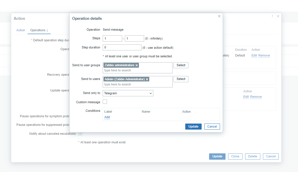

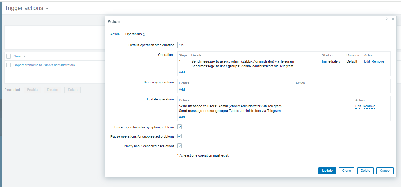

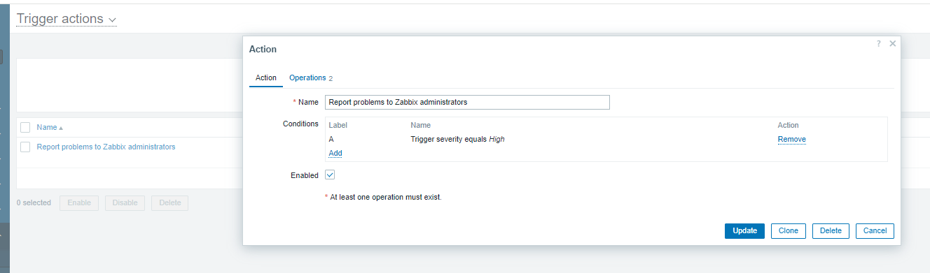

          You can see my trigger setting in attach.

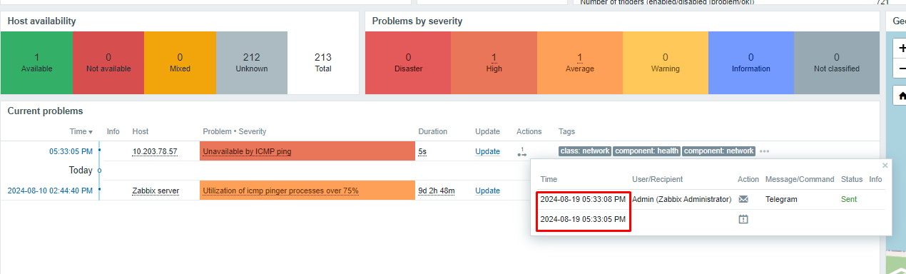

            When i check timeline notification of problem. The system sending notification in 3 second.
            I think my problem is long detection time.
            is it possible descrease detection time ?

                this is your action config, not trigger config...
