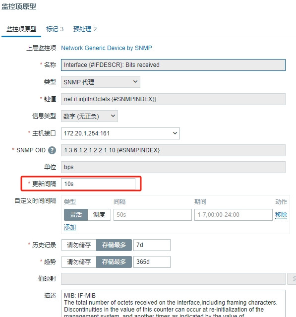

    I am using zabbix to monitor network switches by SNMP, data is collected every 10 seconds, but it is found that 1 minute of data is missing every 10 minutes.
    Is there any configuration I can change to fix this ?

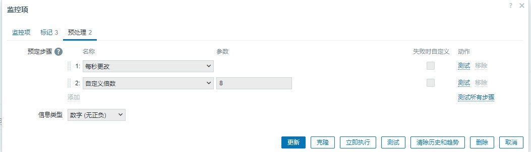

    It's unlikely but could it be that there is a discard when unchanged in the pre-processing? (Even if it's there the chance that 6 read outs all return the same data is small) As a test you could remove it.
    But maybe the read out of the data at all isn't possible?

      It seems weired.

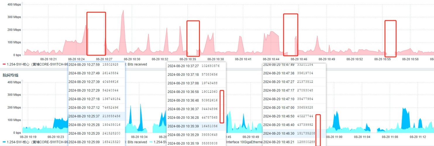

      There are two situations, the first is that there is indeed no data, and the second is that there is data but it is not drawn。
      And, the pre-processing seems nothing to do with this.

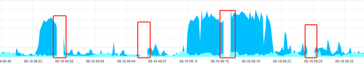

        When looking at your graph the first block (most left) it's clear why nothing is drawn as there is nodata, the other to only show the data entries after the gap. So I expect it has the same reason. So your problem is fixing the nodata issue first.
        Try increasing your interval time from 10s to e.g. 15s and see if that works better.

            Pay attention to the poller utilizations, maybe they have too much to do (because there are gaps in the value list in your picture). See the graphs provided by the Zabbix server template to see the utilization of various internal components of the server.
