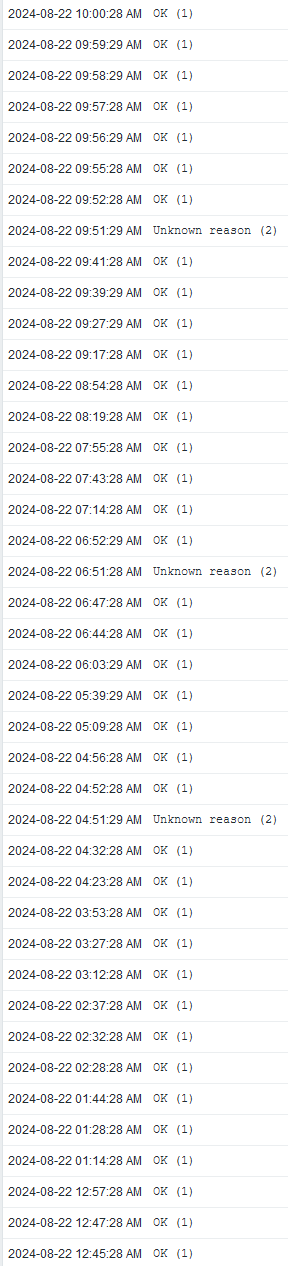

          • staerkl
            • Aug 2024
            Markku This tip was very helpful.Thank you very much.
            After removing the preprocessing, the data is displayed correctly.
            Unfortunately, the recorded values do not match the 6h:
            Is this a bug?​
            • Markku
              • Sep 2018
              • 1784
              I haven't seen that kind of behavior. I'd recommend using the Values list to see the distinct data values, not the graphical view, to be sure the values are really identical.
              Also, I'd guess restarting the relevant server/proxy components may cause data to be saved more frequently than the heartbeat interval.
              Markku

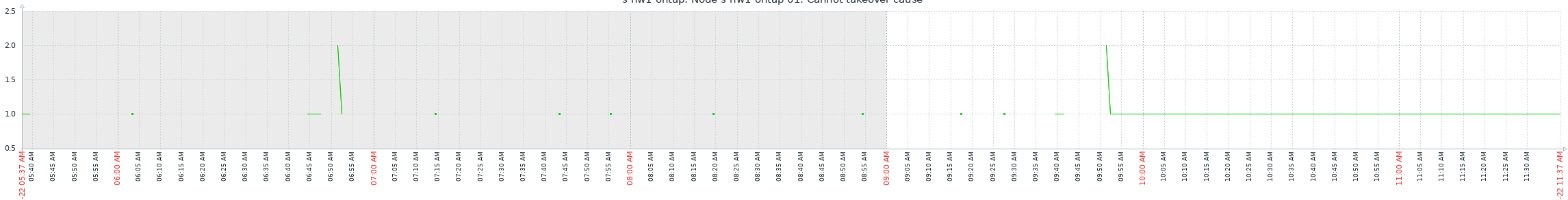

              • staerkl
                • Aug 2024
                I haven't restarted the servers and proxies today.
                Unfortunately I can't find any patterns.
                Click image for larger version  Name:	image.png Views:	0 Size:	56.5 KB ID:	490085
