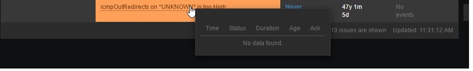

    stuck trigger on dashboard with no host parent
    Since upgrading to Zabbix 3.0.1 from 2.4.x at a client site I have a trigger stuck on the dashboard.
    There is no host associated with the trigger.
    Is there a method to go into the db and remove it manually ?
    Current Zabbix version is 3.2.3 mysqld Centos 6.
      Unfortunately no luck. All interfaces populated.
      There is no specific host to attempt trigger disable.
      I found the source template of the trigger, one I likely un-linked and cleared, however there is no host associated at all with this template now ( as it should be). Its some SNMP_v2 template from a predecessor.
      And on this template I found all triggers are in a disabled state.
      I still lack a host to manipulate on this orphaned dashboard trigger.
