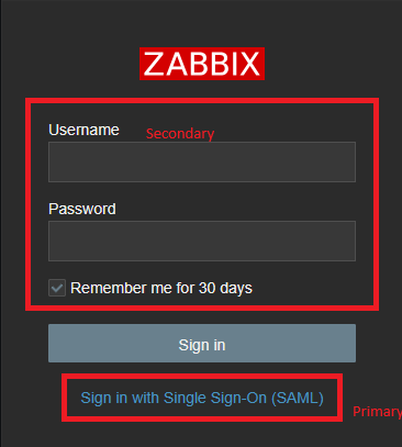

            Re: your second point though - Zabbix authentication can work in multi-mode. We use SSO as our primary means of authentication for every service we onboard. However, each service also maintains a local "emergency access account" in the event that an emergency happens that cannot otherwise be dealt with. Eg: (External) Network outage, IdP outage, Sys. Admin. unexpectedly gets hit by a bus... Is it the best solution? Probably not. But it certainly works well.
