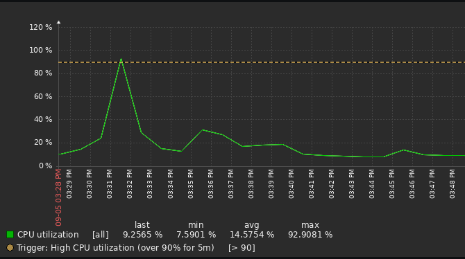

    This is what it appears on one of my system (graph mode)

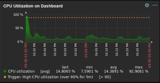

    I found this in the latest values area - but if you wanted it on a dashboard, you just have to create it.

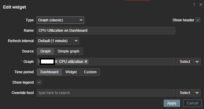

    Here is the setup - just pick your system and the CPU utilization
