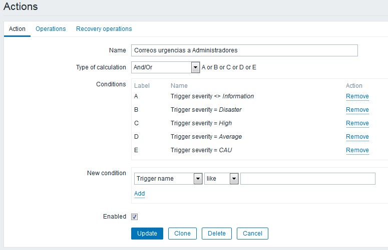

        Hi batchenr,
        Sorry, I need exactly the opposite, someone could tell me what to configure to send the mails with status OK in version 3.2.3. In this version there is no check box "Recovery message".
        I have more than 2000 triggers and now no one informs me when the problem has been fixed.

          there is a box- look closly.
          press at the action name and there at the bottom left
          screen shot if you cant find

            In Zabbix 3.2.3, I have a "Recovery operations" tab, where you can set it up.
            Ex: https://snag.gy/hNJ8yI.jpg

              But it does not appear, attached image
                look at this

                  You have the "Recovery operations" tab on your image..

                      Thank you very much for your help batchenr and SBO,
                      That was what was missing, I did not notice that the tab did not exist in the previous version !!!
