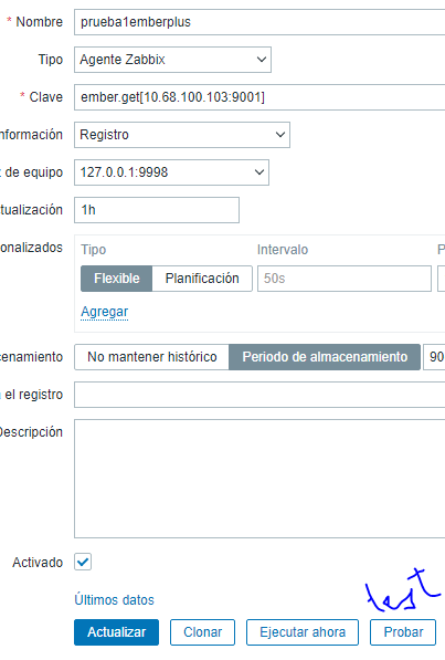

          • 4993
          What do you mean, you cannot do it in frontend..?
          Create your item, give it a name and set key to ember.get[10.68.100.103:9001]. Data type to log.

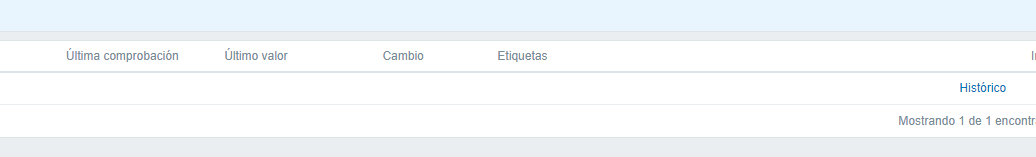

          • Bobal9
            • Jul 2024
            • 13
            historic empty​
            • Bobal9
              • Jul 2024
              • 13
              Now yes
              I had to recreate the item
              Thank you very much.
