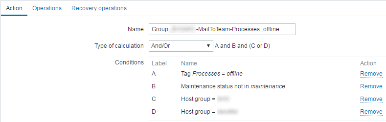

    Is it possible to only send one single email like "some harddisks too full" instead of sending three individual emails? I thought, that's what I could use tags for, but apparently this only leads to Zabbix sending an *additional* email without suppressing the individual ones.

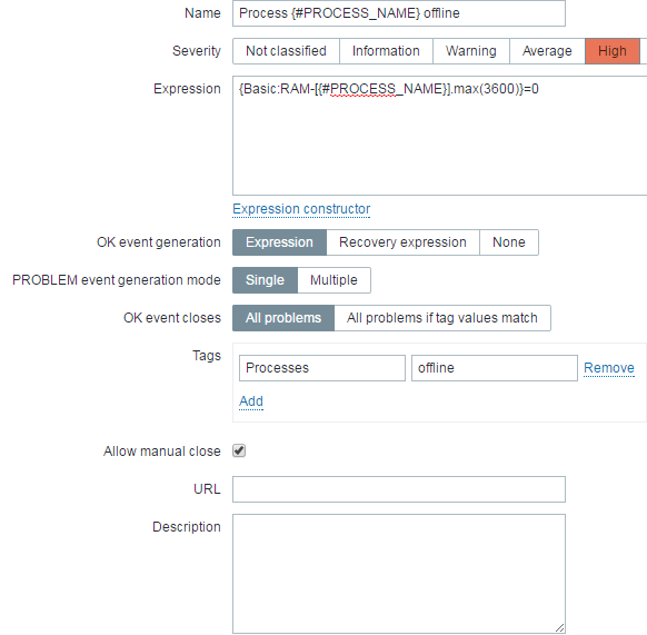

      here goes. As you can see, I tried defining tags, but could not get them evaluated the way I wanted to.
        i think that instead of making a trigger with #PROCESS_NAME
        you should make it as :
        {Basic:RAM-[{RAMHARDDISC-c}].max(3600)} or{Basic:RAM-[{RAMHARDDISC-D}].max(3600)} or {Basic:RAM-[{RAMHARDDISC-E}].max(3600)} or {Basic:RAM-[{RAMHARDDISC-F}].max(3600)}

          thanks for helping! But that's not my point. I need to have these triggers created via Low-Level discovery, because I can not predict which hard disks will be available on the monitored systems.
          Besides, the trigger itself is fine. What I wondered is:
          when I define an action on the tag value, why does zabbix send one email per trigger?
