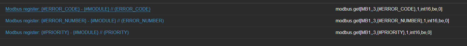

    I have been trying to add additional items in the same Low level discovery trigger. The twist is that i dont need the items for the trigger, but want to include it in the operational data field for "more informasjon" about the problem itself.
    I can start by showing a little (I will censor some info). BTW i use modbus, but the idea is the same. This is the items in the discovery:
    Click image for larger version  Name:	image.png Views:	0 Size:	27.6 KB ID:	491058
    after that i would like to add it to a trigger and the expression itself just include the error_code if it hit a int that is predefined in the relevant document, ERROR_NUMBER and PRIORITY is just additional data i want to give to operational field without impact of problem expression.
