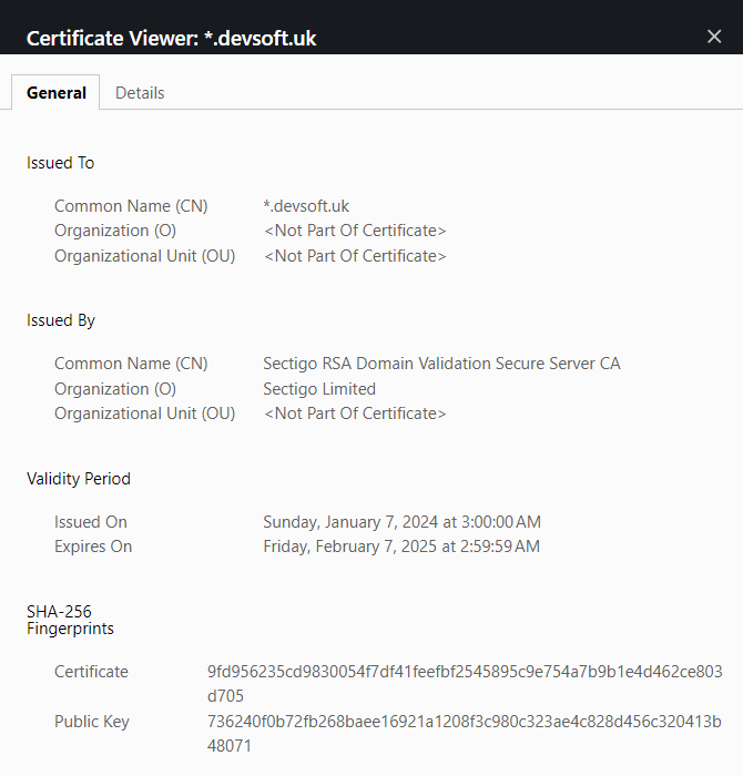

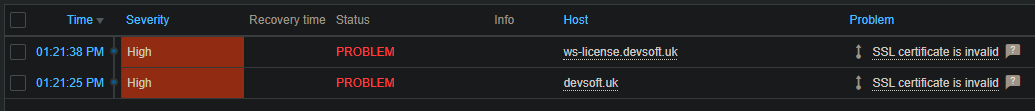

    I am using Zabbix 7.0.3. There is a domain certificate controls installed and among others devsoft.uk domain is reported as a problematic by the "Website certificate by Zabbix agent 2"
    When I check that domain certificate using Opera by visiting the web site it is displayed as valid and details are below.

    I couldn't understand why the tool reported that domain and its sub domains as problematic.

    Most likely the host running the monitor doesn't have the Sectigo CA in its certificate store, hence it can't validate it.
