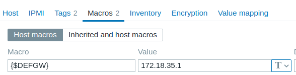

    Hello all.
    I would like to implement a check to verify if the frontend router of a switch is working before eventually trigger problems on the switch it self.
    To better explain, I have a lot of remote switches that are connected via WAN and in front of them there is a router ( handled by several providers ).
    From the zabbix server I check the routers via SNMP, but if the router ( which is not under my control ) is down I don't want to execute the check, nor sending the alert from the triggers.
    To implement this I have added a macro to every switch with the address of the router:
    I would like to create a check Item that ping the DEFGW address, and in case it is not reachable the trigger would be the dependance for all other triggers.
    Is there a way to realize this ? Also with some external action eventually.
    Thanks in advance
    Pierluigi

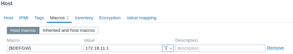

      I have found a way:
      Create a macro in the host:

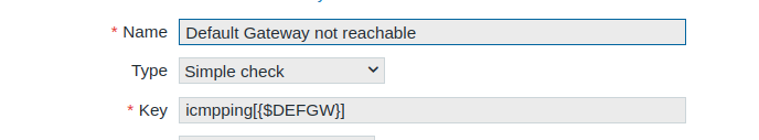

      Then create an item that use this macro as simple action/icmpping:
      Then it's easy to create a trigger and use it as dependency.
      My problem was how to create the item, and I've found how
      Thanks all.
