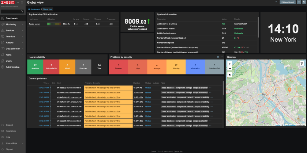

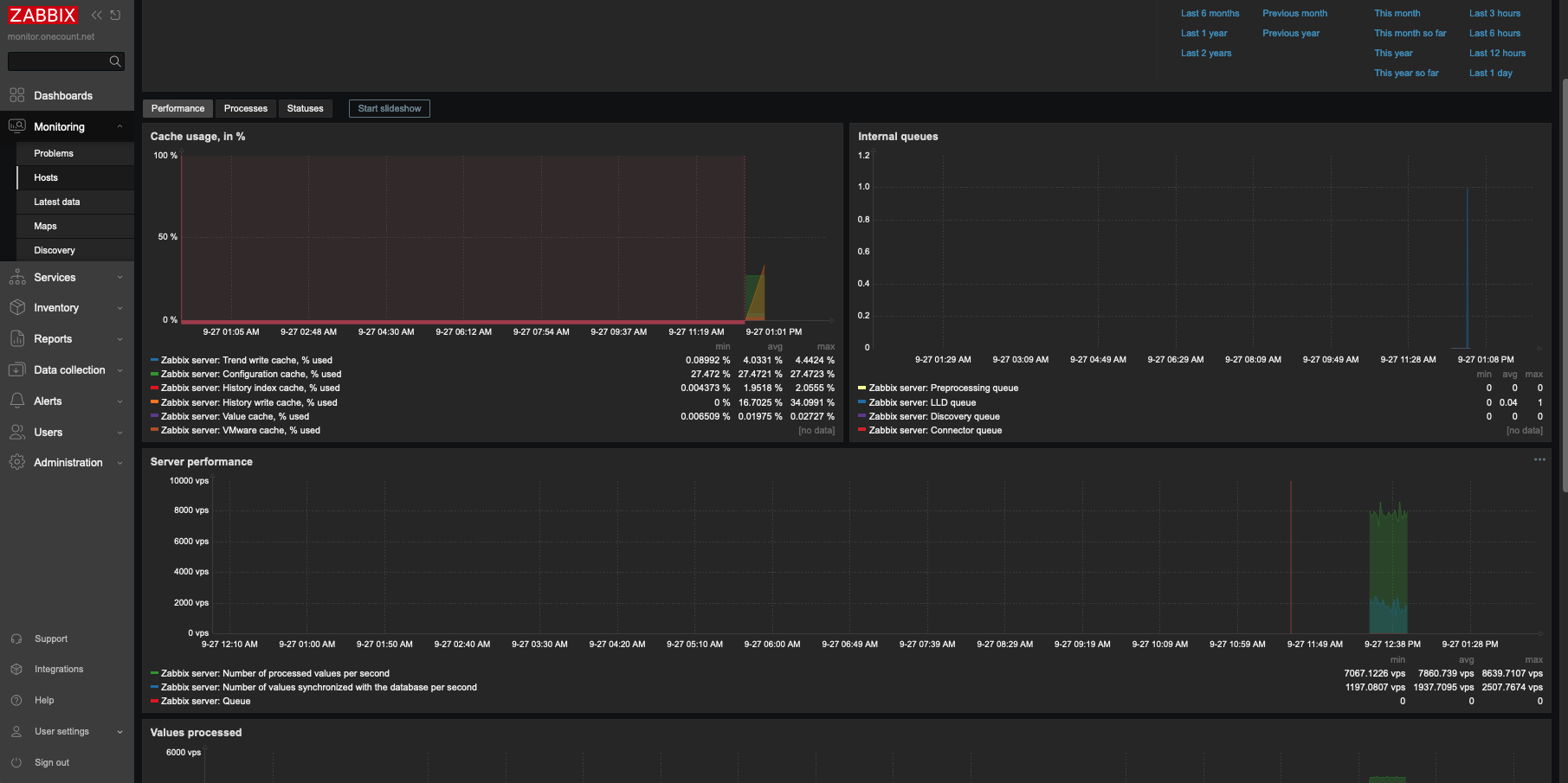

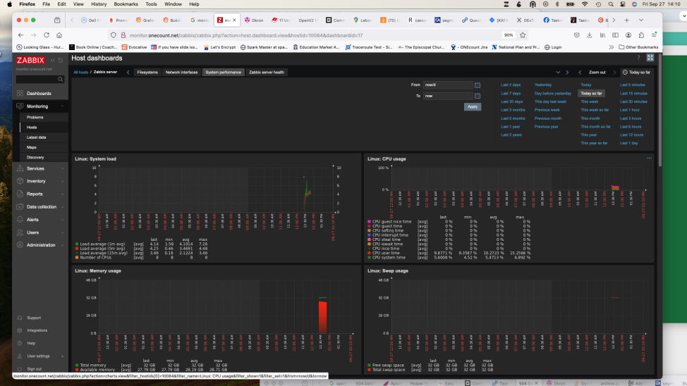

    I've used Zabbix 4.0 for years so I'm not a novice with this. There are a number of templates we want to use that are not supported so we decided to start using Zabbix 7.0. Rather than upgrade, we built a brand new host with Alma9, PHP, MySQL, etc. and installed fresh. Twice. Both times Zabbix turns completely unreliable. I have maybe 20 hosts configured, and there are constant gaps in data collection. I made changes to five of our kafka hosts and re-enabled the JMX interface--I saw the boxes on Zabbix turn green that it was seeing the JMX connection--but no data. For hours. I've read the forums and it's not a connectivity issue or an issue with the device being tracked.
    In my case, Zabbix can't even reliably collect data from itself!
Name:	Screenshot 2024-09-27 at 14.10.28 (2).png
ID:	491910 Click image for larger version
Name:	Screenshot 2024-09-27 at 14.10.53 (2).png
    I've spent about 4 days on this and still can't get it to reliably collect data.
    Any idea how to get this working or where to look? I've seen numerous complaints from other people over the years with similar issues, but no resolution or clues on how to resolve. I've tuned and tuned and am not finding anything to fix. My old install NEVER had problems like this.

      I started with the default and tweaked when it went south. I can put it back to 4. But where did it come with 471K items shown on the dashboard page? I have more than 100 hosts that were configured for my old Zabbix, I did not configure them in the new version however in the logs I see them polling the Zabbix server. They are not set up.

        Yet I see: More than 75% used in the history cache
        And I have:
          I don't understand your install at all. You only have 24 hosts but your system's NVPS is 8009?
          Do any of the templates you applied do auto-discovery / low-level discovery, and if so is it possible that the template "discovered" hundreds of thousands of items for one or more of your hosts?
          If you look at your Hosts view, where it lists counts for items, triggers, etc. for each host, do some of them have a really large number of items?
              Are you re-using the IP or DNS name of the old Zabbix server for the new one? That would explain why the agents are trying to connect to the new server.
              • seanfulton
                • Sep 2024
                • 10
                Yes, we are re-using the server name.
