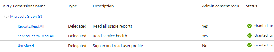

    My Entra app has these API permissions:
    And valid secret in MyApp > Certificates & secrets > Client secret (populated {$MS365.PASSWORD} macro).
    Please, can you help me, what am I doing wrong?

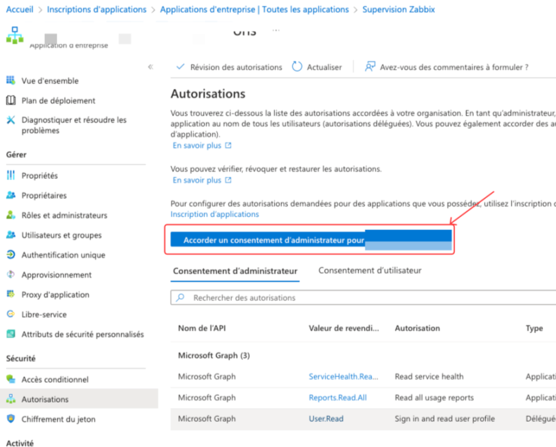

      • Antoine_Grd
        • Jan 2025
        I found my problem. I had to "Request administrator consent" :
