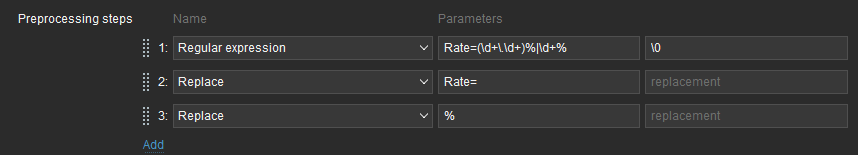

        Thank you for your response!
        I think I solved it (maybe not in the most perfect way) before I had the time to read your response. So far the graph is behaving as expected.
          • 5002
          What is the point of using regex if you are still outputting whole value? Isn't the point of it making your life easier...? q
