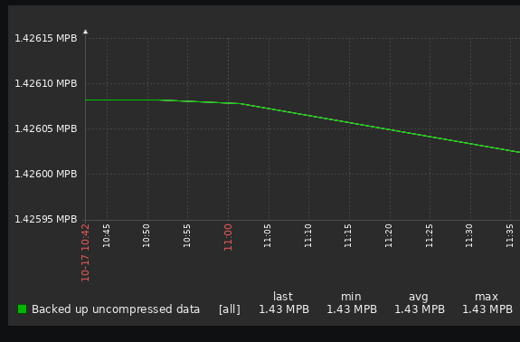

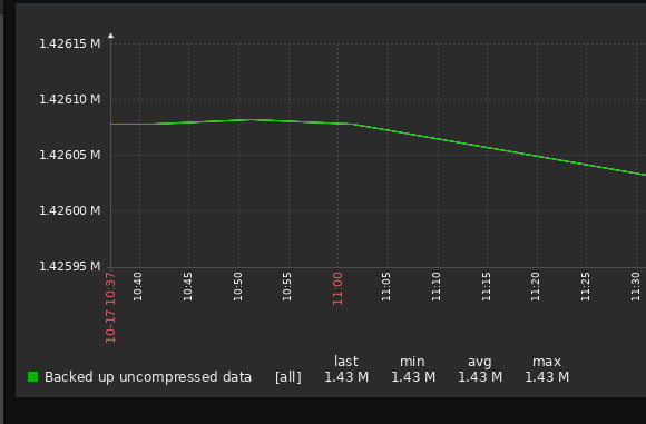

    Hi, so I am experience for me an strange issue. I'll paste a whole lot of screenshots below - hopefully for a better understanding.
    I have this item defined as Numeric (float) with Regular expression (\d+\.\d+) set. When I open the item and check Latest data in the graph it looks like second screenshot below - see it adds the M at the end and even though 1.43 is a better number than below Last value 1425991.5 number since the value actually should be 1.43 PB.
    Click image for larger version  Name:	image.png Views:	1 Size:	6.4 KB ID:	492905
    Click image for larger version  Name:	image.png Views:	1 Size:	17.6 KB ID:	492906

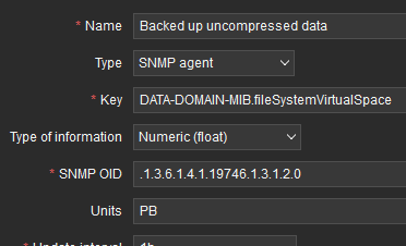

    But if I add PB in Units field it all ends up like this.
    Click image for larger version  Name:	image.png Views:	1 Size:	9.6 KB ID:	492907​
    Click image for larger version  Name:	image.png Views:	1 Size:	5.9 KB ID:	492908​
    Click image for larger version  Name:	image.png Views:	1 Size:	18.7 KB ID:	492909​
    Can someone please help me understand this and perhaps help me solve it?

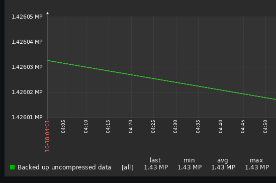

      Hi, when I change to just a letter P instead I get this result - so really no big difference other than one letter missing since before. I really do not understand why Zabbix add the letter M in the beginning.
