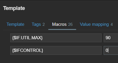

      In the Template, change the macro: {$IFCONTROL} to 0
