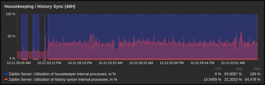

    Housekeeping / History Sync (48H):

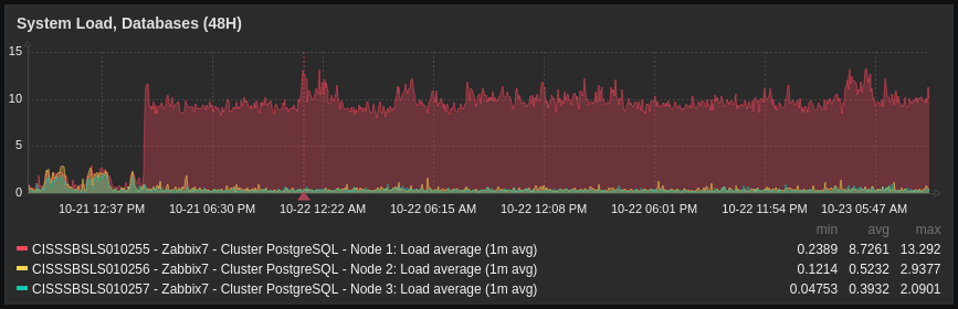

    System load for the databases:

        From what I noticed:
        - Postgresql vacuuming and housekeeping running at the same time is bad. (213 343 607 dead tuples haven't been cleaned)
        - Turning off the Housekeeping brought me back to sub 2 loads. I had to manually force a zabbix-server switch to my second node to make it effective.
        - The history_uint table doesn't seem to be properly indexed, the vacuuming is taking forever even tho I gave it some more resources.
        Steps taken so far to correct the situation:
        - Temp disabling the housekeeping until vacuuming is up to speed
        - Make the vacuum perform faster at cost of some more resources
