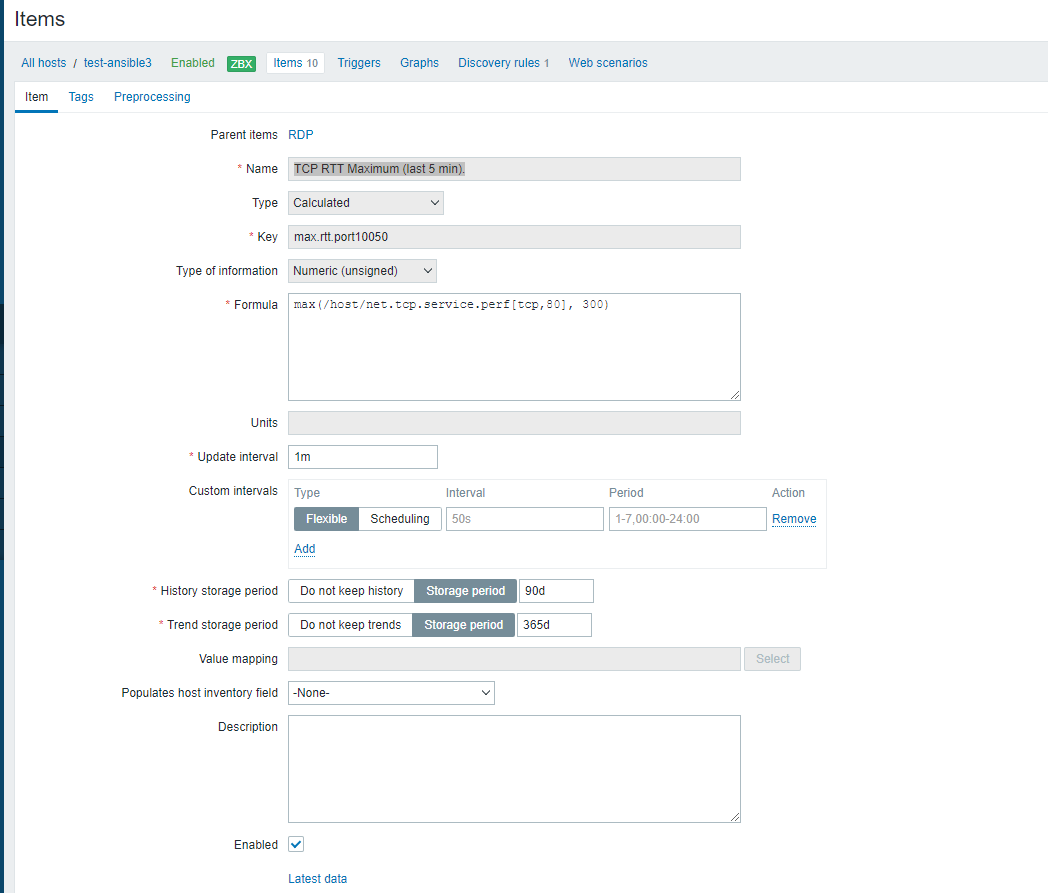

        Here is the screenshot :

        • Hamardaban
          • May 2019
          • 2714
          RTFM !!!!
          /host/ - means the name of the host on which the data element exists "/test-ansimble3/net.tcp......."
          if the formula is created on the same host, you can skip the hostname and write "//net.tcp......."

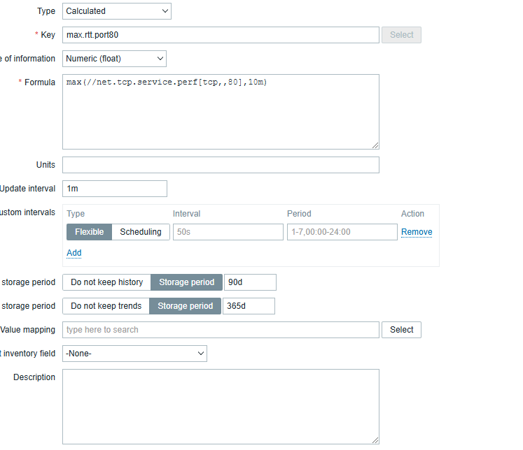

                  • Thomas51
                    Thomas51 commented
                    Thank you for the response. I’m getting the following error: Invalid parameter '/1/params': incorrect expression starting from 'max(//net.tcp.service.perf[tcp,,80],10m

                • Thomas51
                  • Oct 2024
                  • 19
                  Here is the screenshot;

                  • ISiroshtan
                    • Nov 2019
                    • 324
                    Tried to add similar item in my 6.4 and all went fine. Can you also show me the screenshot of existing item with key net.tcp.service.perf[tcp,,80],10m) ?
                    • Thomas51
                      Thomas51 commented
                      I updated the server, and that resolved the issue tranks
