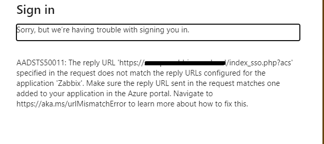

We're looking to implement SAML SSO on our instance, however we're coming across this error.

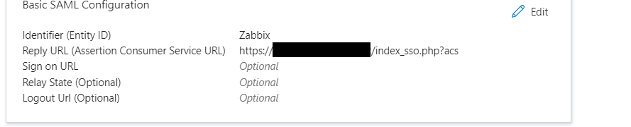

We configured Azure with the following:

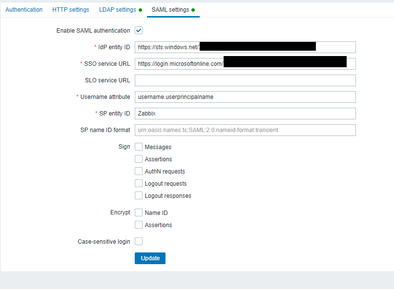

Zabbix with the following
We downloaded the idp.crt base64 version and popped it in the correct location on the server.
Attributes and claims are set for username.userprincipalname as the email address
There is no reverse proxy or load balancer, I tried adding the proxy header string into the config just in case, but no luck. We seem to go through the authentication fine, it's just when it redirects back to Zabbix it thinks it is the wrong reply URL even though we don't believe it is. The only thing to mention is we are using an internal CA certificate, does this require a public SSL cert or could anyone suggest anything else to check?
