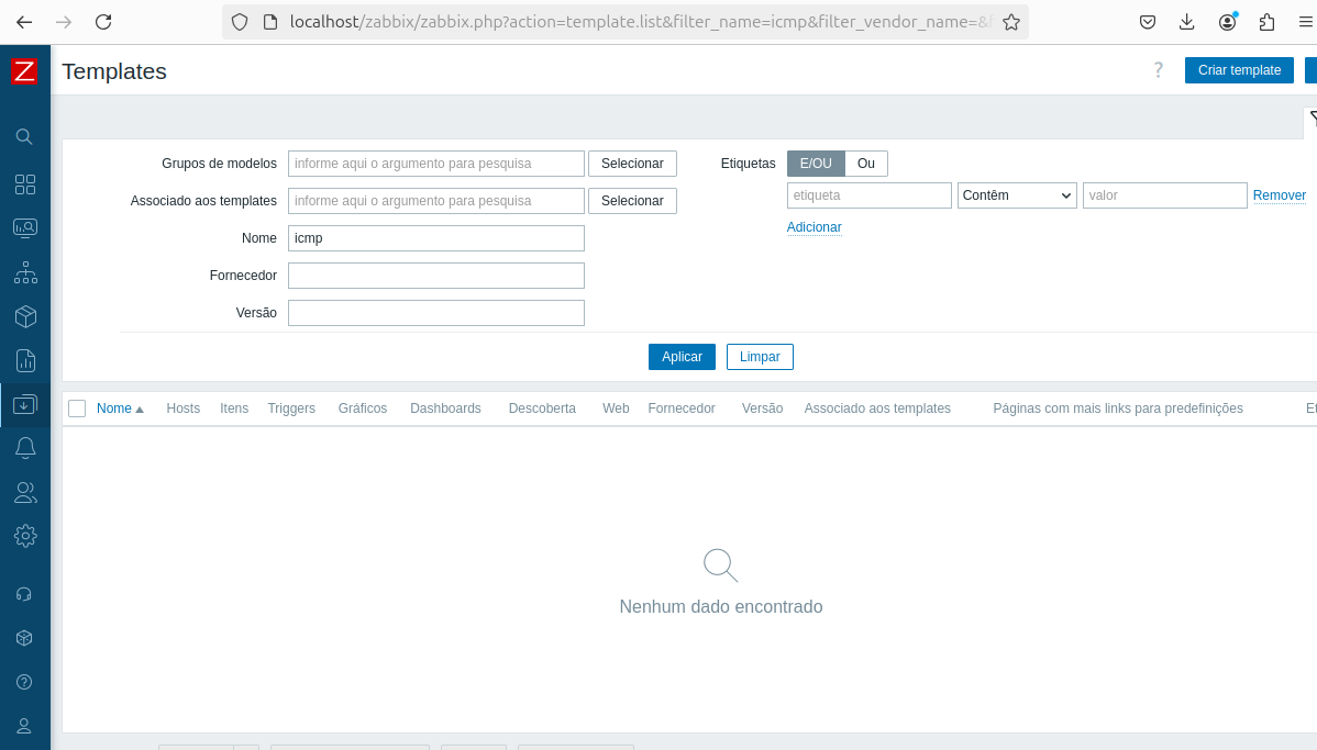

    template icmp
    I installed Zabbix 7.2, but when I tried to access the ICMP template (ping, packet loss, and latency), I saw that it wasn't in the system. Is there any other way I can use it or import it? If so, please send it.
  • Answer selected by [email protected] at 28-10-2024, 16:11.
    markfree
    • Apr 2019
    • 875
    It means that your Zabbix host does not have Fping installed.
    Zabbix relies on Fping for ICMP checks.
    So, you could try to download it, something like "apt install fping" (depending on your distro).
    • galavichid
      • Mar 2021
      • 45
      You can download it from here: Source of 00template_module_icmp_ping.yaml - Zabbix - ZABBIX GIT
      Save the file, go to Data Collection > Template > Import (on the top right corner)

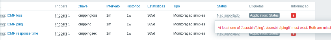

          hello
          I imported it, but this message from the print is appearing now.
          Do you know what it could be?
          • markfree
            • Apr 2019
            • 875

              Steps to Solve the Issue
              • Checked the Path of fping and fping6: On Ubuntu, both fping and fping6 were located in /usr/bin, while Zabbix was looking for them in /usr/sbin. I verified this with:
                bash
                which fping which fping6
              • Created Symbolic Links to the Paths Expected by Zabbix: To ensure Zabbix could find them, I created symbolic links in /usr/sbin:
                bash
                sudo ln -s /usr/bin/fping /usr/sbin/fping sudo ln -s /usr/bin/fping6 /usr/sbin/fping6
              • Adjusted Permissions for Zabbix: I also adjusted the execution permissions to ensure Zabbix could use fping and fping6:
                bash
                sudo chmod +s /usr/bin/fping sudo chmod +s /usr/bin/fping6
              • Restarted the Zabbix Server and Agent: After these changes, I restarted the Zabbix services to apply the updates:
                bash
                sudo systemctl restart zabbix-server sudo systemctl restart zabbix-agent
              • markfree
                • Apr 2019
                • 875
                I see. That's good.
                For systems where Fping's path is different, Zabbix Server has the FpingLocation and Fping6Location parameters where you can especify the Fping binary path.
                You can have either way.
