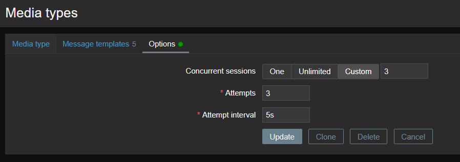

      Look under your media type options... But you may need to adjust, how many alerter processes there is.. https://www.zabbix.com/documentation...#startalerters

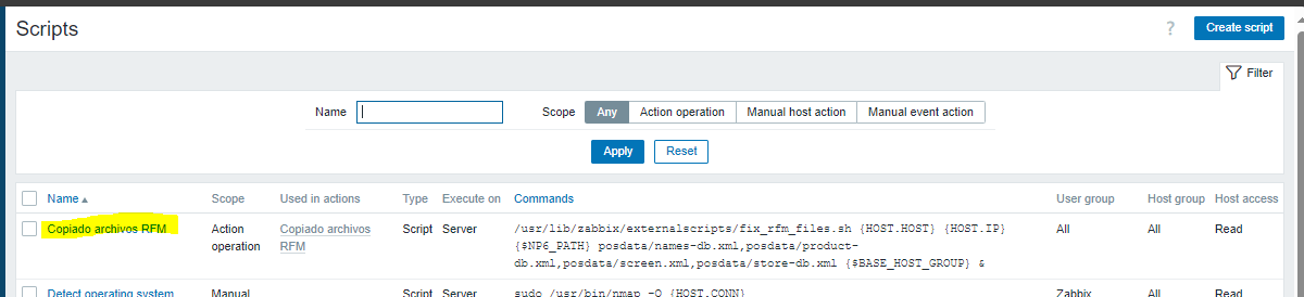

        i have the script.

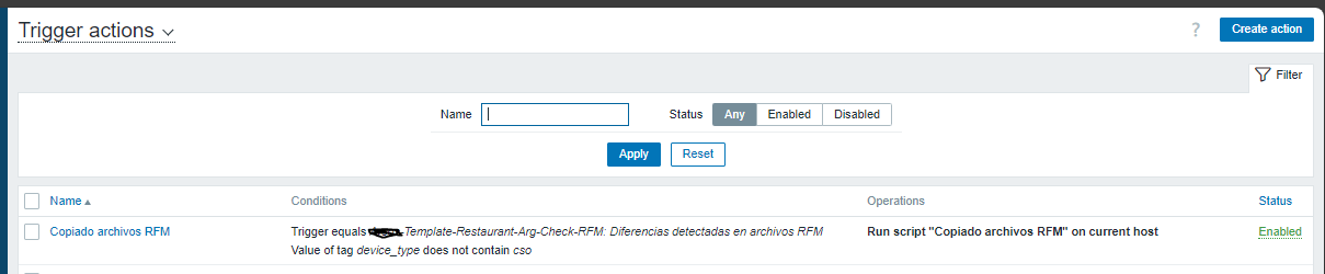

        and the trigger action.

          Parallelism.. I may be wrong, but by executing an script as trigger action, it will wait until it finishes, but "sending a message" to user gives it over to alert manager, which then allows parallel executions... and also retries if something fails...
