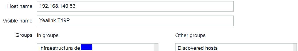

            Maybe im wrong, but the thing is: can Zabbix monitor a IMCP Ping just with the template? I mean without the Zabbix agent. That you said before ZBX have to be activate but its not because im not using the agent.
            • onallion
              • Mar 2016
              • 131
              You don't need an agent for simple checks, but you do need to put the host's IP/DNS in the interface...
              • runtothehills
                • Nov 2016
                This is the configuration of my host, everything looks OK. I made the entire config of Zabbix that the official manual says. https://www.zabbix.com/documentation/3.0/manual
