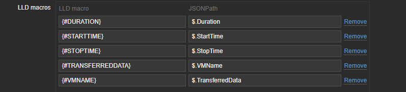

    I have read up on multiple blogs and he help guide but am confused on how to get this data into Zabbix. I have tried the following:
    Create a template with a discovery rule and LLD macro processing within the discovery rule

    So you created your "master" item and it collect data. Create a discovery, set type to "dependent item" and point master item to your item that collects JSON. As discovery itself will not be assigning data into items, you will not need that many LLD Macros. You need only those that would be used in item/trigger names and keys. As such you can leave only {#VMNAME} macro (the path is correct on screenshot).

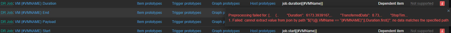

      The data collects fine though I think I may have done something wrong in the dependant discovery rule as keep getting the belo error

        Based on screenshot you created 4 discovery rules. That is not what you want. You need to create a single discovery rule without preprocessing (Name it as "DR Jobs discovery" for example). Then inside of discovery rule you create 4 item prototypes of dependent item type, point them to same item as discovery rule itself and add preprocessing in each of items to extract on single value,

          Like said above me, the json path of your discovery rules is what you should have used in Item Prototypes > pre-processing part.
          The LLD Macros of your first post should be part of your 1 and only discovery rules.
          Your end result should be something like, 1 discovery rules (depended on your data gathering item) and 4 item prototypes (depended on your data gathering item). And with a LLD macro in the itemkey, And pre-processing jsonpath.
