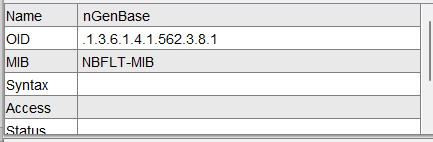

            In mib file said node does exist:
            nGenBase OBJECT IDENTIFIER ::= {ngen 1}

              Originally posted by ISiroshtan
              Also you imported NBFLT-MIB into mib folder also, right?
              Click image for larger version  Name:	image.png Views:	7 Size:	5.2 KB ID:	494054​
              Yes, I've already imported this mib into mib folder.

              that why I'm so confused, the node in mib file exists but it said it cannot find that node. My brain-dead TT
