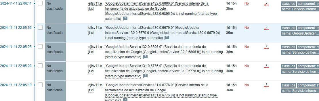

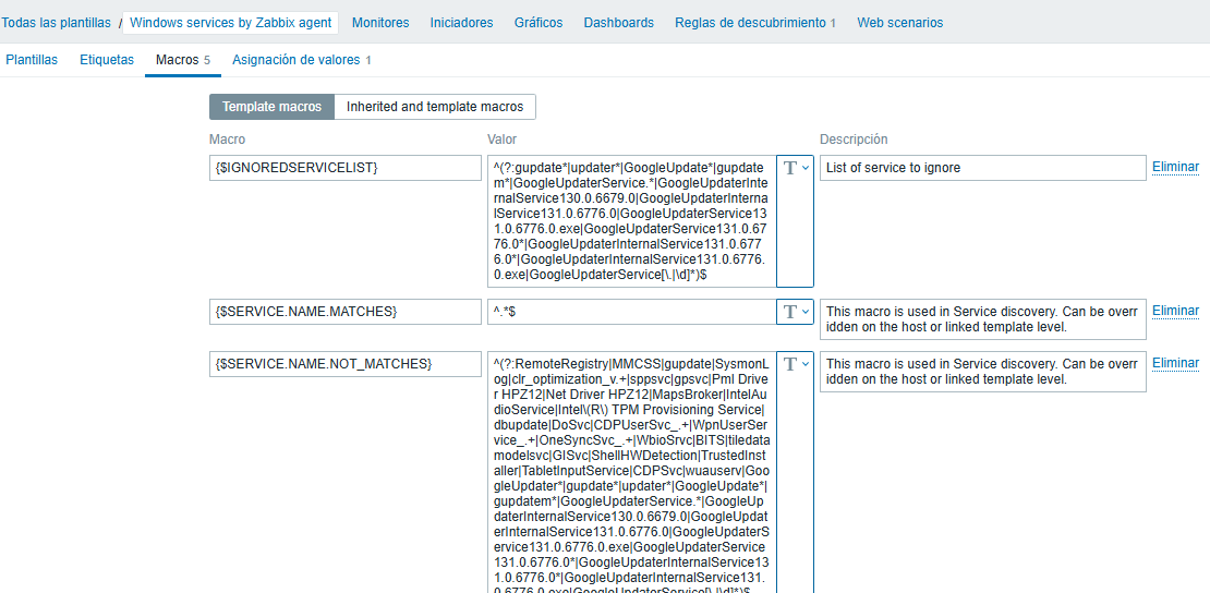

    Hello, I am working with zabbix and I am getting some messages about (GoogleUpdaterService132.0.6806.0)) is not running (startup type automatic), I have tried several methods to prevent them from appearing and I have not been successful, please can someone help me? I appreciate itClick image for larger version

    help please
    (GoogleUpdaterInternalService132.0.6806.0)) is not running (startup type automatic)

      After you added the service to filter out macros, did you delete already discovered instances of service on hosts?
      Filter will prevent new items to be discovered, but existing items will remain there until "keep lost resources" timer would expire
