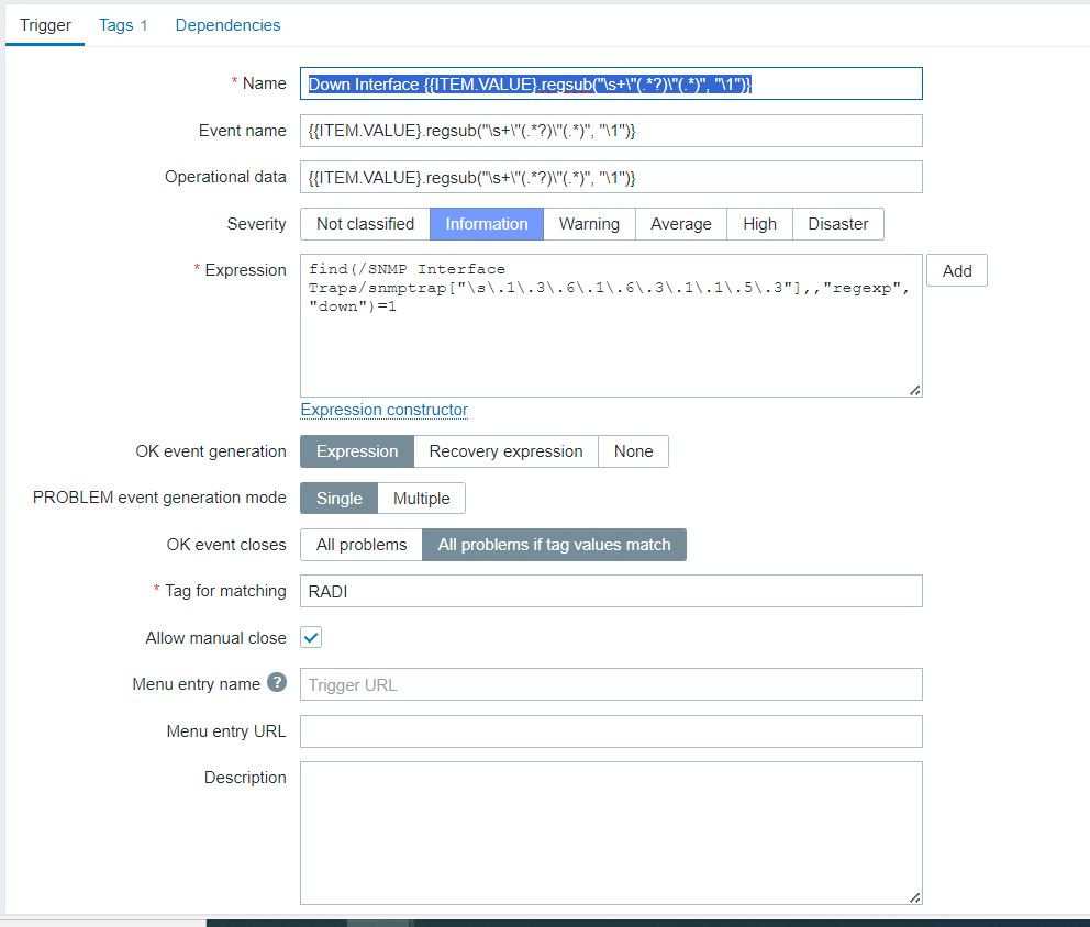

    hi!
    I ve tried x times to configure these trigger but without success.
    i am recieving traps down/up. see them in logs
    se in gui as problem when traps arrived .but when it has to be cleared it is failing.sometimes is working somtimes not .i am really lost ideas what to try anymore.i am pretty new to zabbix .
    i put in attach my last trigger conf.
    i will be grateful for your help.

        this is my new conf of trigger :
        find(/SNMP Interface Traps/snmptrap["\s\.1\.3\.6\.1\.6\.3\.1\.1\.5\.3"],,"regexp","down")=1
        it works even like this
        find(/SNMP Interface Traps/snmptrap["\s\.1\.3\.6\.1\.6\.3\.1\.1\.5\.3"])=1
        it generate problem

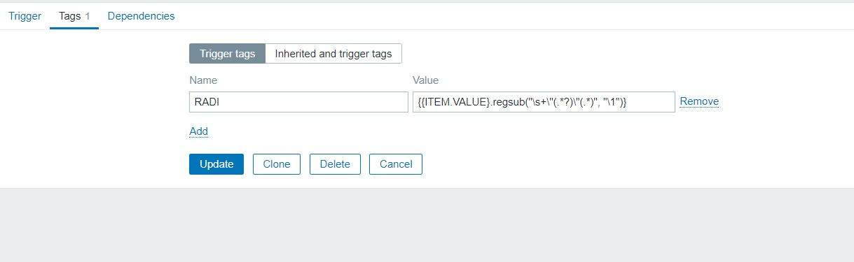

        i put for OK event option "expression"
        I create tag for matchin exact interfcace .it works. {{ITEM.VALUE}.regsub("\s+"(.*?)"(.*)", "\1")}
        But RESOLVED never happend. in trap logs there is no new interface down traps but PROBLEM persist.
        so what should I do?

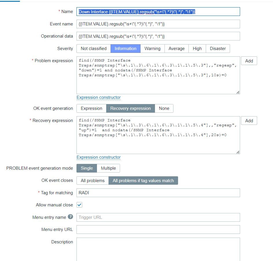

      hi! here is my new trigger configuration for snmptrap interface down. and recovery is not working at all. in attachment is configuration of trigger and tag
      i ll appreciate much your help.

          Why overcomplicate things? Just feed both linkDown and linkUp traps into same zabbix item. I think the key should be snmptrap["\s\.1\.3\.6\.1\.6\.3\.1\.1\.5\.[34]"] or snmptrap["\s\.1\.3\.6\.1\.6\.3\.1\.1\.5\.(3|4)"]
          Then have trigger "find(/SNMP Interface Traps/snmptrap["\s\.1\.3\.6\.1\.6\.3\.1\.1\.5\.(3|4)"],,"regexp","down")=1" trigger and it will work. When last message is ifDown - alert will fire. When last message is ifUp - alert will resolve.
          (Unrelated: why using numeric OIDs? it's horrible! Why not instal proper MIBs and deal with OID names instead?)
          After you test the above, you can proceed to specific interface detection setup.
          Assuming your regex to extract interface index works:
          Add recovery expression "find(/SNMP Interface Traps/snmptrap["\s\.1\.3\.6\.1\.6\.3\.1\.1\.5\.(3|4)"],,"regexp","up")=1"
          Problem event generation mode - multiple
          OK even closes - if tag matches
          Tag for match - RADI

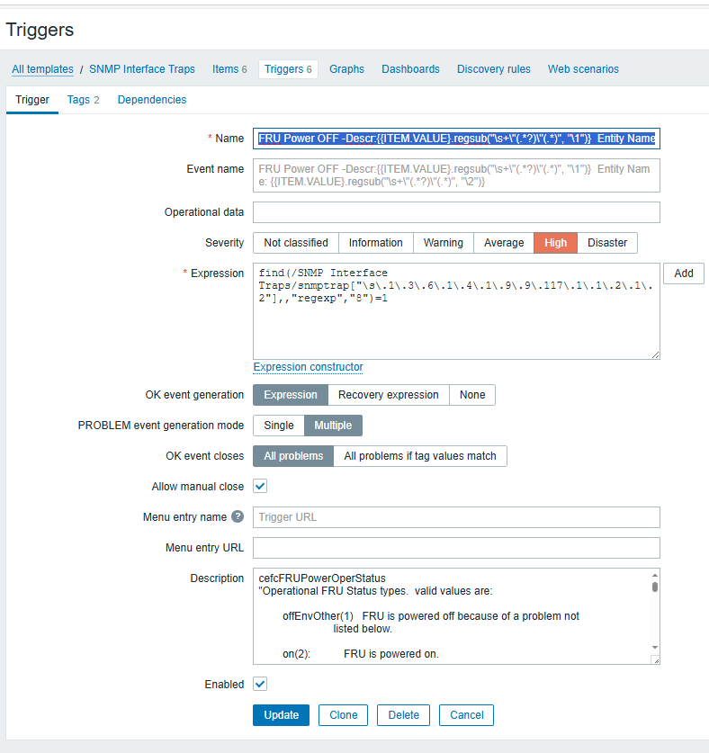

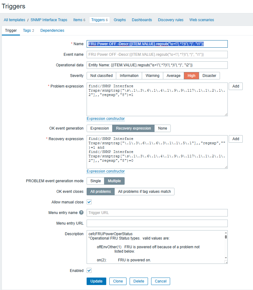

                        Here am I again. now I have request fo "cold start" trap to clear "dying gasp" trap .
                        I didnt successed to make expretion which works. All trpas are coming but cold start anyhow cant clear dying gasp. I made to version but both not working .any idea? in future i will have more request liek this and is really becoming painfull every time I have trouble with clear match. ( .so some universal guidance for matching traps for clear would appriciate .thx a lot in advance!
                        br,
                        marijana
