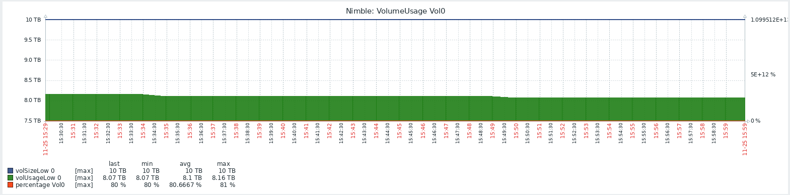

    Is it possible to create a two axis graph?
    I am looking to create a two axis graph (an example from internet attached for reference)

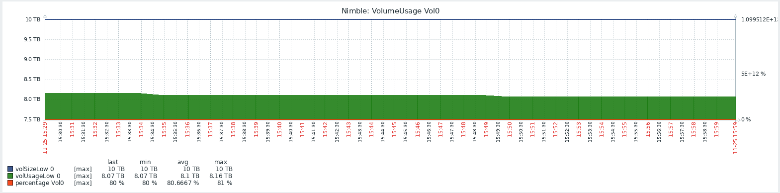

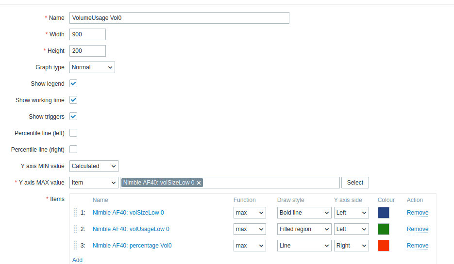

    On the left side I would like to add Disc Size and Ocupation, and on the right site the percentage of ocupation, but it doesn't work (even when aligning to the right)
    But it shows like this
ID:	494863 I haven't find any mention of this types of graph in the forums, so I don't know if they are supported in zabbix.

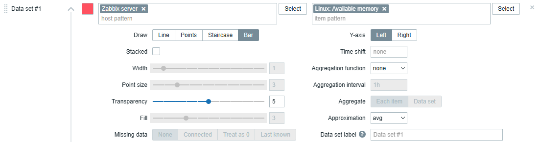

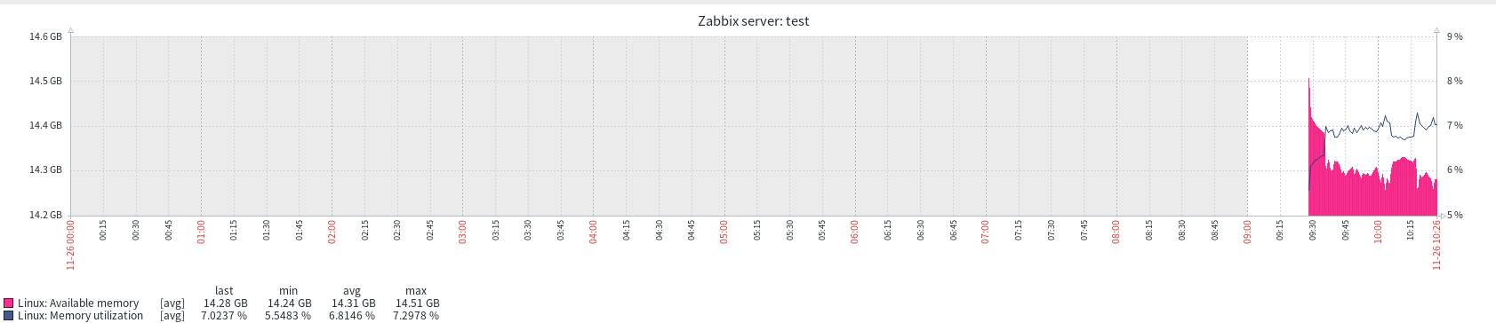

    Hi, I was able to do it using dashboards widgets.
    Here is what I put in data set
Name:	Screenshot 2024-11-26 085326.png
Name:	Screenshot 2024-11-26 085552.png
    ​​Hope that helps you.

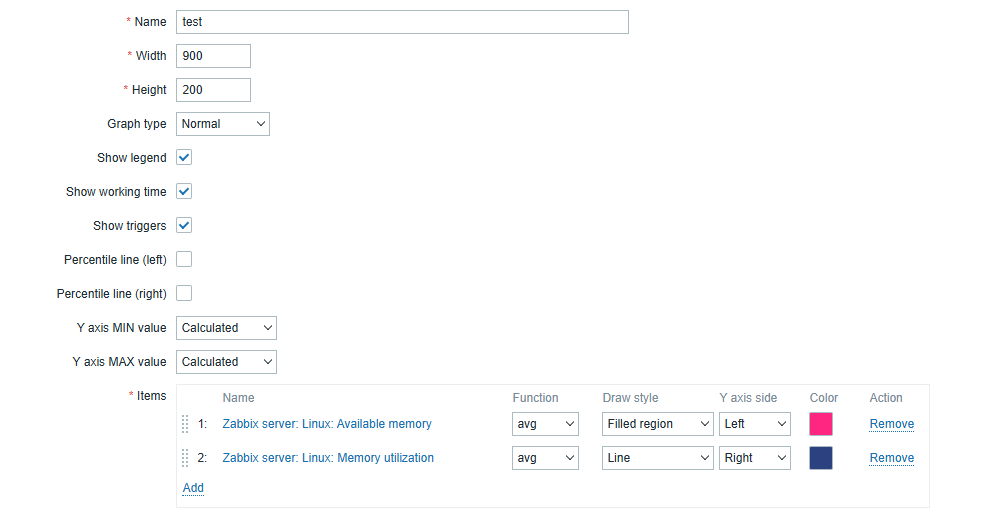

      Also possible to create as graph in host
Name:	Screenshot 2024-11-26 092724.png
Name:	Screenshot 2024-11-26 092923.png

        It is working but your issue is that you are using a Y-Axis MAX item rather than calculated. This [annoyingly] applies to both Y axes whether you like it or not! Change it to Calculated and it will behave as you expect.
        • aseques
          • May 2019
          • 40

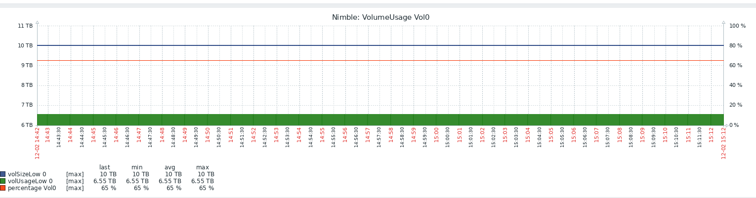

          Thanks troffasky it was as you said, after having both as calculated the data shows fine. Julianna Wilamowska you already have both set at calculated, that's why you had it ok too.
          Thanks to all , it now shows the proper data
