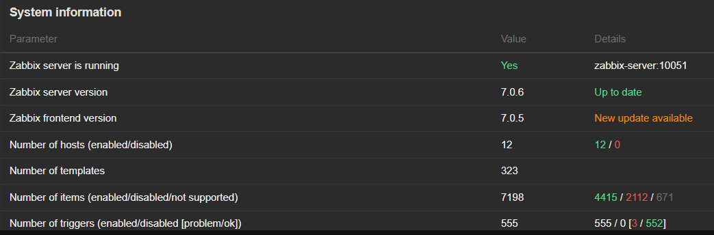

    Yesterday, with the help of Portainer, I've tried my first update from Zabbix 7.0.5 to version 7.0.6 but dashboard keeps saying an update is available:
Name:	2024-11-26 09_46_58-Zabbix docker_ Dashboard and 4 more pages - Work - Microsoft​ Edge.png
    As you can see, server is updated but not the frontend.

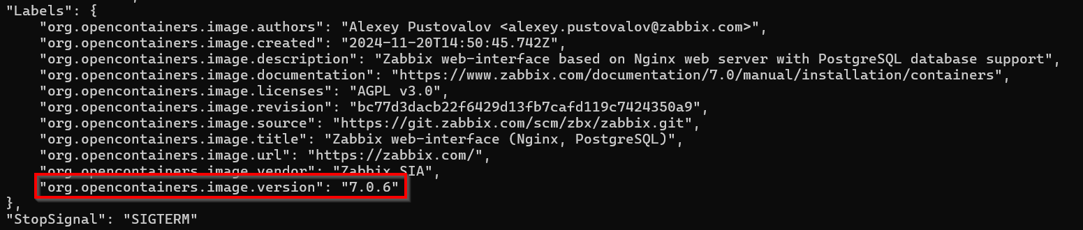

    What is really strange, is that the frontend image seems to be updated, here is the result of the docker inspect image command:
Name:	2024-11-26 09_50_11-Portainer _ local and 4 more pages - Work - Microsoft​ Edge.png

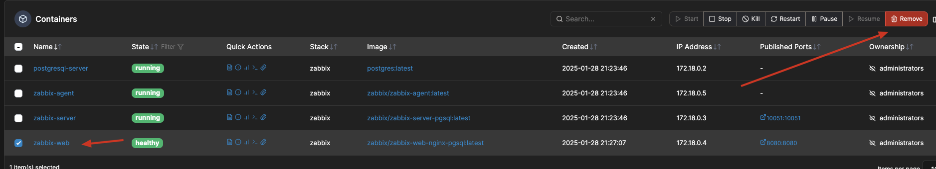

      1.) I stopped the whole stack (docker compose file)
      2.) deleted the zabbix-web:

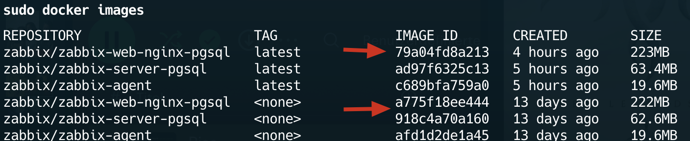

      3.) Then I manually delete the Docker Images for zabbix-web-nginx-sql:
      Delete Image with: Docker image rm (both ids)

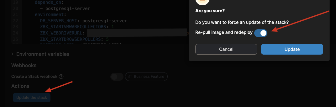

      4.) Start the docker compose file:

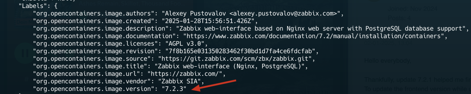

      The GUI still shows me the old version but docker inspect shows the new version:
      Do you have a idea?
