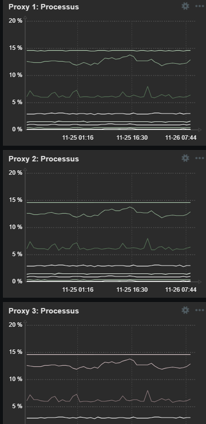

    Hello everyone, first topic for me.
    I'm on Zabbix 6.0, I have several proxy servers on my Zabbix, and I'd like to display the graphs of my process (thanks to internal checks)
    But all of them seems the same:
    Moreover, I can see the same datas on my Zabbix Server.
    So here is my question: Do you know if I can display datas, like pollers utilization for example, for each proxy and zabbix-server ?
    Thanks for your help.
    Guigz

    Are the Zabbix Proxy hosts in Zabbix UI are set to be monitored by Proxy themselves? Or are they set to be monitored by Zabbix server? Internal checks executed by whoever is doing the monitoring, so if Proxy Server host is set to be monitored by Zabbix server, the internal check would be executed by server itself showing the Server internal data.
    From documentation:
    Internal checks allow to monitor the internal processes of Zabbix. In other words, you can monitor what goes on with Zabbix server or Zabbix proxy.
    Internal checks are calculated:
    • on Zabbix server - if the host is monitored by server
    • on Zabbix proxy - if the host is monitored by proxy

      Hi, you can display data for internal checks for each proxy. From the photos it looks like it is showing you the same data for each proxy, are you sure you have set it up correctly? Can you check your config file/ graph settings/ proxy settings to make sure you are not monitoring just one proxy?
        From documentation:

          Thank you both of you for your help,
          It think you find the problem ISiroshtan, my proxies are, indeed, monitored by the Zabbix server (did not see these lines on the doc )
          Thanks again, and have a good day
