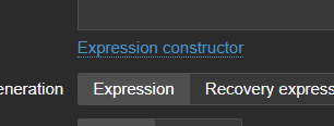

          Trigger testing is possible. If you open triger config, theres also a link "expression constructor"
          if you use it, there will also be a "Test" button, where you can submit values to expression and see result...

            Thank you, all now is working fine, but after restarting the server only (docker version). I didn't know about this expression constructor, I will look at it right now
