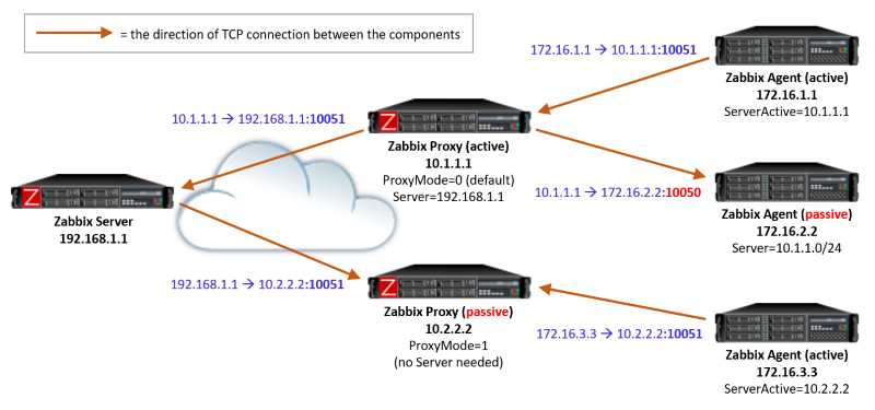

              In active mode Zabbix agent does not need any incoming connections, instead the agent would initiate connection to Zabbix server/proxy to port 10051, will get all configuration data it needs and will be reporting metrics same exact way. For it to work you need:
              • set in agent configuration file the ServerActive directive
              • ensure that agent -> server/proxy tcp:10051 communication is open and successful
              • ensure that in Zabbix server the host is configured with items of "agent(active)" type checks
              The image below is a good representation of how communication flows look based on active/passive settings

                Having said that, didn't you make a typo in the server link to passive proxy, the port shouldn't be 10050?
                  • 4949
                  10050 is AGENT port.. if server talks to proxy, it will connect to 10051 on proxy. Same port where active agent will send data on proxy...

                  Hello @Isiroshtan
                  First some questions I don’t understanf on you drawing
                  • Server → Passive Prox 10051 ? Typing mistake ? Should be 10050 ?
                  • Active Proxy : Server=192.168.1.1 ? Should be public IP of server?
                  • Zabbix Agent not the local network than Active Proxy ?

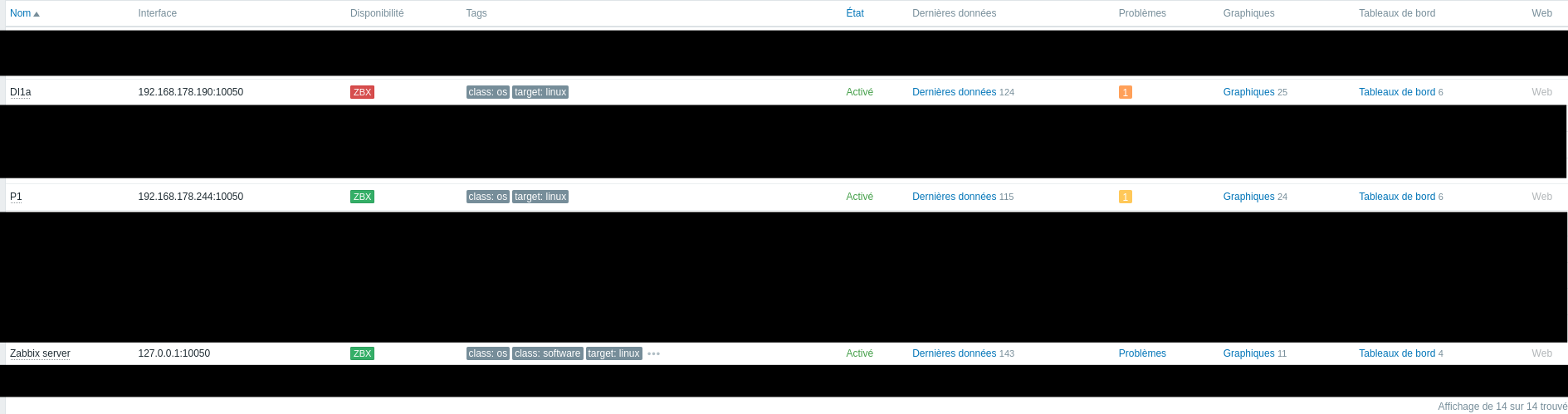

                  On my proxy I reject port 10050 in input
                  • iptables -A INPUT -p tcp --dport 10050 -j REJECT (comand done yesterday)
                  My proxy agent2 does not work anymore
                  • I see this with this 2 sreens
                    • Avaibility : green → red

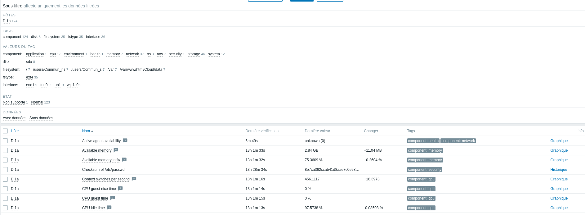

                  • Last data time
                  So, my main question, port 10050 seems to be mandatory even in active mode, except, of course, if I did mistakes in my config, but I don’t see where ?
                  And I have a second question regarding the agent (P1) connected to the proxy
                  • It works ! Without the proxy working !
                    • Avaibility in green (see previous image)
                    • Last data time Ok
