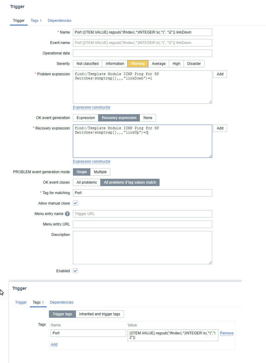

    I have created a trigger to create a linkDown trap but the recovery (linkUp) is not clearing the problem. The linkup comes very quickly after the linkDown so not sure if that is related to the issue.

    Attached is the screenshot for my trigger. I have checked the regular expression and it matches the ifIndex value ok
    I know that polling would fix this but I have to rely on traps.
    I am new to zabbix so may have missed something obvious but any ideas what the issue may be?

    One thing.. use "PROBLEM event generation mode" -> Multiple. Otherwise it will not generate any other down events, while one is already triggered..
    But otherwise... I managed to replicate this and it works just fine... (with zabbix v6)
    Do you see portnumbers extracted nicely in tag values? That regsub had issues with multiline values, IIRC... So it may not extract, what you need and then things do not match any more...

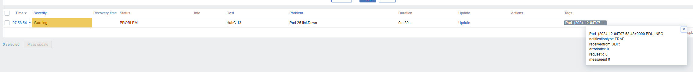

    • wildm
      wildm commented
      Thanks for this. I realise I posted this question in the wrong place really.
      I checked and it does look like the tag is the issue - see attached screenshot in comment below.
      I am on version 7 and the same regex works when used in the name of the problem - just not in the tag. Is there a known workaround for this by any chance?

    Tag appears to not be working

      For myself, I have resovled it by adding a preprocessing to items "replace all linebreaks (\n) with ";;" ". Then your trap is saved as one line and regsub will work much better..
      ie.
      {{ITEM.VALUE}.regsub("ifIndex = (.*?);;","\1")}
      if your saved data looks like
      20241203.174847 UDP: [sender IP]:34857->[receiver IP]:162;;DISMAN-EVENT-MIB::sysUpTimeInstance = 0:0:00:00.00;;SNMPv2-MIB::snmpTrapOID.0 = IF-MIB::linkUp;;IF-MIB::ifIndex = 2;;IF-MIB::ifAdminStatus = down;;IF-MIB::ifOperStatus = up
      • wildm
        wildm commented
        Thank you. I have implemented and the tag looks ok - e.g. Port 2
        I just need to check that the clear is working but no reason to think it should not be,
