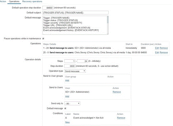

                What if you try steps 1-24 send to admin users
                steps 25-0 send to sysadmin this way steps won't overlap and following rule will not get in your way:
                Several operations can be assigned to the same step. If these operations have different step duration defined, the shortest one is taken into account and applied to the step.

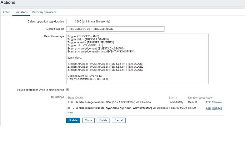

                    Originally posted by duncan9562
                    Can you screen shot your Operation details for step 1, and post them here?
                    Hello duncan9562 Thank you for the reply, This was my old Config.
                    • Gsmith
                      • Mar 2015
                      • 56
                      This is my new Configuration as VSO suggested
                      • Gsmith
                        • Mar 2015
                        • 56
                        Limited step #1 to 24 did the trick. Not exactly what I want to happen for an Escalation, but it did solve one of my problems.
                        Thank you VSO for the suggestion. I guess if a trigger is going off Not-Ack for more then 24 hours I have a employee problem also.
