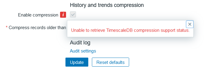

    Those commands allow me to correctly raise a Zabbix service, but when I check if TimescaleDB is active in the housekeeping menu, it is not.
    To fix it, I have done the following:
    wget https://repo.zabbix.com/zabbix/7.0/debian/pool/main/z/zabbix/zabbix-sql-scripts_7.0.6-1%2Bdebian12_all.deb
    sudo dpkg -i zabbix-sql-scripts_7.0.6-1+debian12_all.deb
    cat /usr/share/zabbix-sql-scripts/postgresql/timescaledb/schema.sql
    I run this script inside the Zabbix database that is in the TimescaleDB container and it executes correctly, but when I enter the housekeeping menu, I see the following error:
    Searching with Google, I have found several answers with solutions for the previous versions of Zabbix. I have tried everything and I have not been able to solve this problem with the new version 7.
    Has anyone else had this problem and found a solution?
