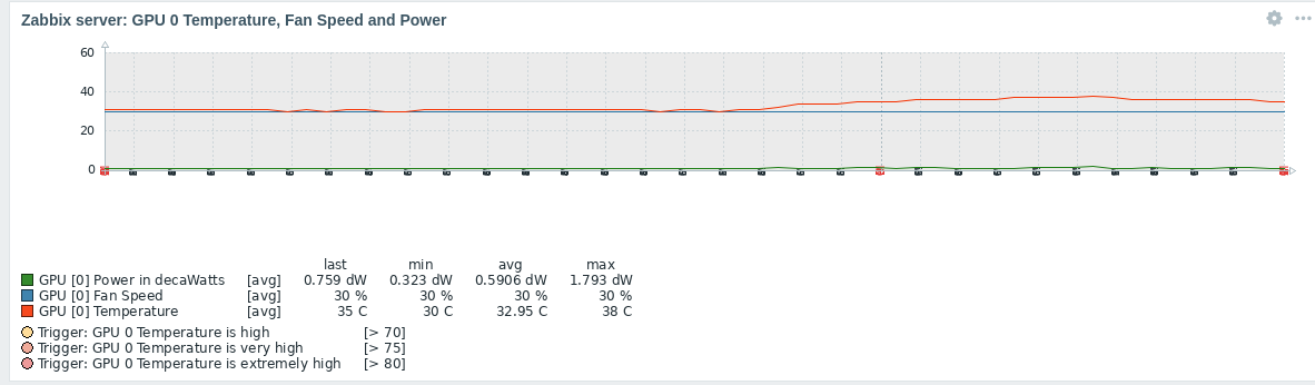

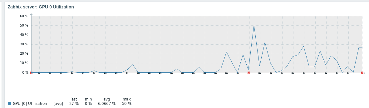

    Hello Dear all, I encountered a problem specifically the parameter "GPU utilization" does not show, I tried three templates, all as one show the temperature aand how much GPU memory is used and free. All these three options of templates and scripts, including the one below, work perfectly on Ubuntu and show all the parameters
Name:	Screenshot From 2024-12-09 21-21-06.png
Name:	Screenshot From 2024-12-09 21-21-13.png
