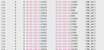

    I cannot seem to figure out how to stop the TIME_WAIT on this for UserParameter Requests.
    I found some posts on how to create the request
    UserParameter=nuke_i.available,/opt/foundry/rlmutil rlmstat -avail -a -c 4101@foundry-lic | sed -n '/nuke_i/,$p'| grep nuke_i | awk -F'[^0-9]*' '{sum+=$4} END {print sum}'
    I'm just using the agent2 on my license servers and making the requests in using the conf file.
    I've managed to request everything I need.
    But after a while my license servers freak out and this is the output of netstat -an
    I thought to increase my ulimits but after increasing it, i found that rlm does this already by default already.
    Has anyone resolved this before?

  • Jeffrey_223
    • Apr 2024
    Anyone able to help me troubleshoot this?
