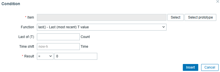

          • Brambo
            • Jul 2023
            • 256
            I think you should either look into how to build a trigger and or use the select option in the create trigger section.
            The code you supply in example 2 cant work at all.
            And as code example 2 cant work it would suprise me you make an error in example 1 as well.
            Start using the add button next to the expression field and create your expression from there: Click image for larger version
